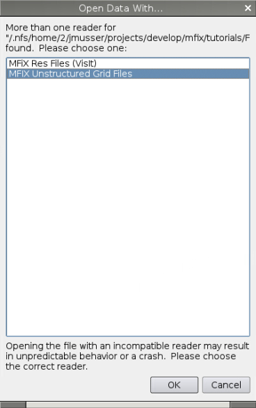

Newer versions of ParaView require that you select the appropriate reader. Choose to open the data with “MFiX Unstructured Grid Files”. (Figure 7.3)
Figure 7.3 Select “MFiX Unstructured Grid Files”¶
