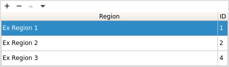

Initial conditions (ICs) are specified in the Initial conditions task pane. ICs summarized in the IC summary table illustrated in Figure 4.5. The MFiX solver will apply ICs in the order that they are defined in this pane. As a result, if two or more regions overlap, the IC with the larger index (ID) is used in the intersecting region. IC IDs are shown in the table, and can be changed using the up and down arrows.
Figure 4.5 Initial condition (IC) summary table.¶
4.8.1. Creating an Initial Condition Region¶
To define an initial condition, there must be a region already defined in the Regions Pane.
