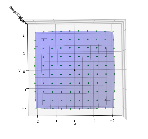

Ex. 2: Refinement
This extension builds on Example 1 and will investigate the numerical response given at the minimum point. The analytical solution at the minimum for f(x,y) = x2 + y2 should be f(0,0) = 0, yet the response surface result is at ~0.016, close to 0, but let’s see if we can get closer to the true minimum.
../_images/response_7.png
Rotating the response surface to view the domain from the bottom, we can see where the DOE sample points are in green and the minimum point in black. Since the response surface is a best-fit curve about the response points it is possible the surface isn’t refined enough to capture the true value at the optimum point. It is often good practice to refine the DOE around the found optimum point. Changing the range from -1.0 to 1.0 for both x and y plus increasing the steps from 10 to 21 increases the resolution around the optimum and provides a response point very near the previously found RSM optimum. Performing the minimization again places the optimum at near zero once again, and the response value at 0.015243289834525817. While this did not significantly improve the RSM prediction at the optimum, it is generally good practice to verify using this procedure.
../_images/response_81.png
