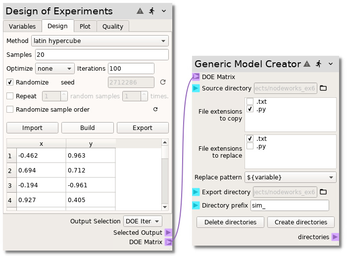

Open Nodeworks
, create a new sheet, and add a Design of Experiments node. On the
variables tab, create a new variable by pressing the button. Change the
variable name from
x1
to just x
, matching the first variable in the
sample.txt
file. Next, change the range of the variable, replacing the
0
in the from
field with -1
. Follow the same process to add another
variable by pressing the button, Change the variable name from
x2
to
y
, and replace the 0
in the from
field with -1
Next, make the samples by going to the Design
tab, selecting
latin hypercude
as the Method
and changing the number of Samples
from the default 10
to 20
. Finally, generate the samples by pressing
the Build
button.
Now, add a Generic Model Creator node to the sheet and connect the DOE Matrix
terminal from the Design of Experiments node to the DOE Matrix
terminal on the
Generic Model Creator node. Select the Source directory
by clicking the
button and browsing to the directory created in Step 1 (
nodeworks_ex6
). The
File extensions to copy
and File extensions to replace
lists will be
populated with all the file extensions in the Source directory
. In this
example, you should only see .py
and .txt
. In the
list, check the .py
extension. In the
list, check the .txt
extension. The
Export directory
will automatically be set to the Source directory
and
we will leave the default Directory prefix
as sim_
The Generic Model Creator
node is now set up to create a new directory for each sample in the DOE matrix,
copying the run.py
file into the new directories as well as copy the
sample.txt
file into the new directories while replacing the ${x}
and
${y}
variables with the correct sample values. Press the
Create directories
button to actually create the directories. The project
directory should now look like:
nodeworks_ex6
├── run.py
├── sample.txt
├── sim_000000
| ├── run.py
| ├── sample_dict.json
| └── sample.txt
├── sim_000001
| ├── run.py
| └── sample.txt
etc.
Note
The sample_dict.json
file contains the variables and values used to
replace the variable names in the selected file extensions. It is a json
file that will look something like:
{"x": -0.4622, "y": 0.9629}
