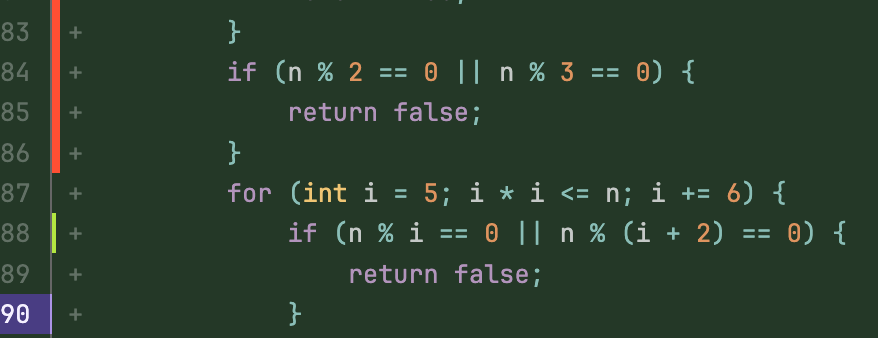

For JaCoCo coverage reports to work, you must generate a properly formatted JaCoCo XML file that provides line coverage.
The JaCoCo coverage reports visualization supports:

JaCoCo reports provide relative file paths but coverage report visualizations require absolute paths. GitLab attempts to convert the relative paths to absolute paths, using data from the related merge requests.
