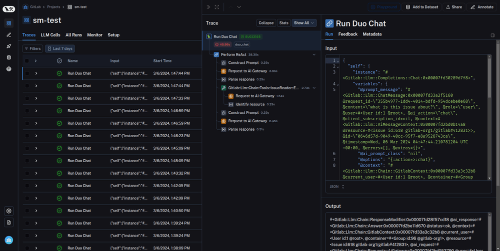

Tracing with LangSmith
Tracing is a powerful tool for understanding the behavior of your LLM application. LangSmith has best-in-class tracing capabilities, and it's integrated with GitLab Duo Chat. Tracing can help you track down issues like:
  • I'm new to GitLab Duo Chat and would like to understand what's going on under the hood.
  • Where exactly the process failed when you got an unexpected answer.
  • Which process was a bottle neck of the latency.
  • What tool was used for an ambiguous question.
LangSmith UI
Tracing is especially useful for evaluation that runs GitLab Duo Chat against large dataset. LangSmith integration works with any tools, including Prompt Library and RSpec tests.
Use tracing with LangSmith
NOTE: Tracing is available in Development and Testing environment only. It's not available in Production environment.
  1. Access to LangSmith site and create an account (You can also be added to GitLab organization).
  2. Create an API key (be careful where you create API key - they can be created in personal namespace or in GL namespace).
  3. Set the following environment variables in GDK. You can define it in env.runit or directly export in the terminal.
    export LANGCHAIN_TRACING_V2=true
    export LANGCHAIN_API_KEY='<your-api-key>'
    export LANGCHAIN_PROJECT='<your-project-name>'
    export LANGCHAIN_ENDPOINT='api.smith.langchain.com'
    export GITLAB_RAILS_RACK_TIMEOUT=180 # Extending puma timeout for using LangSmith with Prompt Library as the evaluation tool.
Project name is the existing project in LangSmith or new one. It's enough to put new name in the environment variable - project will be created during request.
  1. Restart GDK.
  2. Ask any question to chat.
  3. Observe project in the LangSmith page > Projects > [Project name]. 'Runs' tab should contain your last requests.

How a Chat prompt is constructed
All Chat requests are resolved with the GitLab GraphQL API. And, for now, prompts for 3rd party LLMs are hard-coded into the GitLab codebase.
But if you want to make a change to a Chat prompt, it isn't as obvious as finding the string in a single file. Chat prompt construction is hard to follow because the prompt is put together over the course of many steps. Here is the flow of how we construct a Chat prompt:
  1. API request is made to the GraphQL AI Mutation; request contains user Chat input. (code)
  2. GraphQL mutation calls Llm::ExecuteMethodService#execute (code)
  3. Llm::ExecuteMethodService#execute sees that the chat method was sent to the GraphQL API and calls Llm::ChatService#execute (code)
  4. Llm::ChatService#execute calls schedule_completion_worker, which is defined in Llm::BaseService (the base class for ChatService) (code)
  5. schedule_completion_worker calls Llm::CompletionWorker.perform_for, which asynchronously enqueues the job (code)
  6. Llm::CompletionWorker#perform is called when the job runs. It deserializes the user input and other message context and passes that over to Llm::Internal::CompletionService#execute (code)
  7. Llm::Internal::CompletionService#execute calls Gitlab::Llm::CompletionsFactory#completion!, which pulls the ai_action from original GraphQL request and initializes a new instance of Gitlab::Llm::Completions::Chat and calls execute on it (code)
  8. Gitlab::Llm::Completions::Chat#execute calls Gitlab::Llm::Chain::Agents::ZeroShot::Executor. (code)
  9. Gitlab::Llm::Chain::Agents::ZeroShot::Executor#execute calls execute_streamed_request, which calls request, a method defined in the AiDependent concern (code)
  10. (*) AiDependent#request pulls the base prompt from provider_prompt_class.prompt. For Chat, the provider prompt class is ZeroShot::Prompts::Anthropic (code)
  11. (*) ZeroShot::Prompts::Anthropic.prompt pulls a base prompt and formats it in the way that Anthropic expects it for the Text Completions API (code)
  12. (*) As part of constructing the prompt for Anthropic, ZeroShot::Prompts::Anthropic.prompt makes a call to the base_prompt class method, which is defined in ZeroShot::Prompts::Base (code)
  13. (*) ZeroShot::Prompts::Base.base_prompt calls Utils::Prompt.no_role_text and passes prompt_version to the method call. The prompt_version option resolves to PROMPT_TEMPLATE from ZeroShot::Executor (code)
  14. (*) PROMPT_TEMPLATE is where the tools available and definitions for each tool are interpolated into the zero shot prompt using the format method. (code
  15. (*) The PROMPT_TEMPLATE is interpolated into the default_system_prompt, defined (here) in the ZeroShot::Prompts::Base.base_prompt method call, and that whole big prompt string is sent to ai_request.request (code)
  16. ai_request is defined in Llm::Completions::Chat and evaluates to either AiGateway or Anthropic depending on the presence of a feature flag. On production, we use AiGateway so this documentation follows that codepath. (code
  17. ai_request.request routes to Llm::Chain::Requests::AiGateway#request, which calls ai_client.stream (code)
  18. ai_client.stream routes to Gitlab::Llm::AiGateway::Client#stream, which makes an API request to the AI Gateway /v1/chat/completion endpoint (code)
  19. We've now made our first request to the AI Gateway. If the LLM says that the answer to the first request is a final answer, we parse the answer and return it (code)
  20. (*) If the first answer is not final, the "thoughts" and "picked tools" from the first LLM request are parsed and then the relevant tool class is called. (code)
  21. The tool executor classes also include Concerns::AiDependent and use the included request method similar to how ZeroShot::Executor does (example). The request method uses the same ai_request instance that was injected into the context in Llm::Completions::Chat. For Chat, this is Gitlab::Llm::Chain::Requests::AiGateway. So, essentially the same request to the AI Gateway is put together but with a different prompt / PROMPT_TEMPLATE than for the first request (Example tool prompt template)
  22. If the tool answer is not final, the response is added to agent_scratchpad and the loop in ZeroShot::Executor starts again, adding the additional context to the request. It loops to up to 10 times until a final answer is reached.
