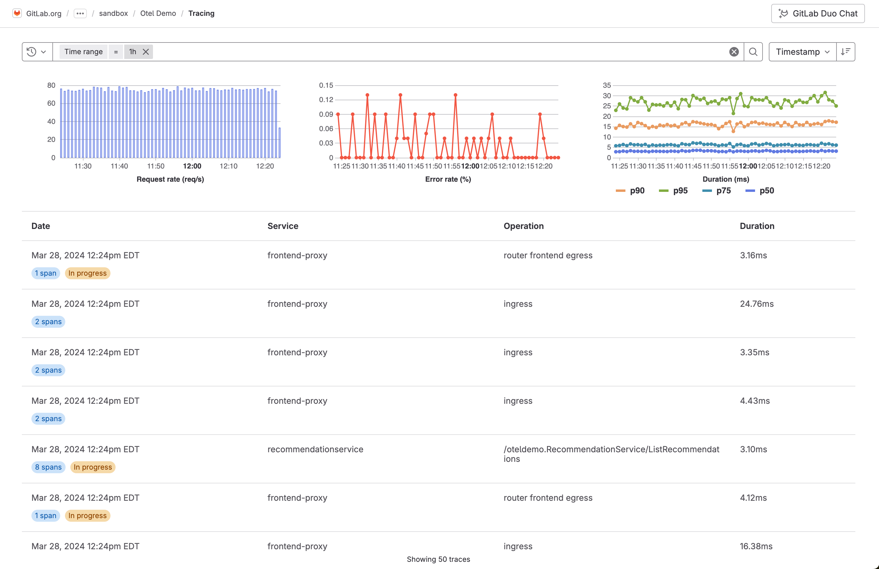

To view the list of traces:
  1. On the top bar, select Search or go to and find your project.
  2. Select Monitor > Traces.
  3. Optional. To view the details of a trace, select it from the list.
    list of traces

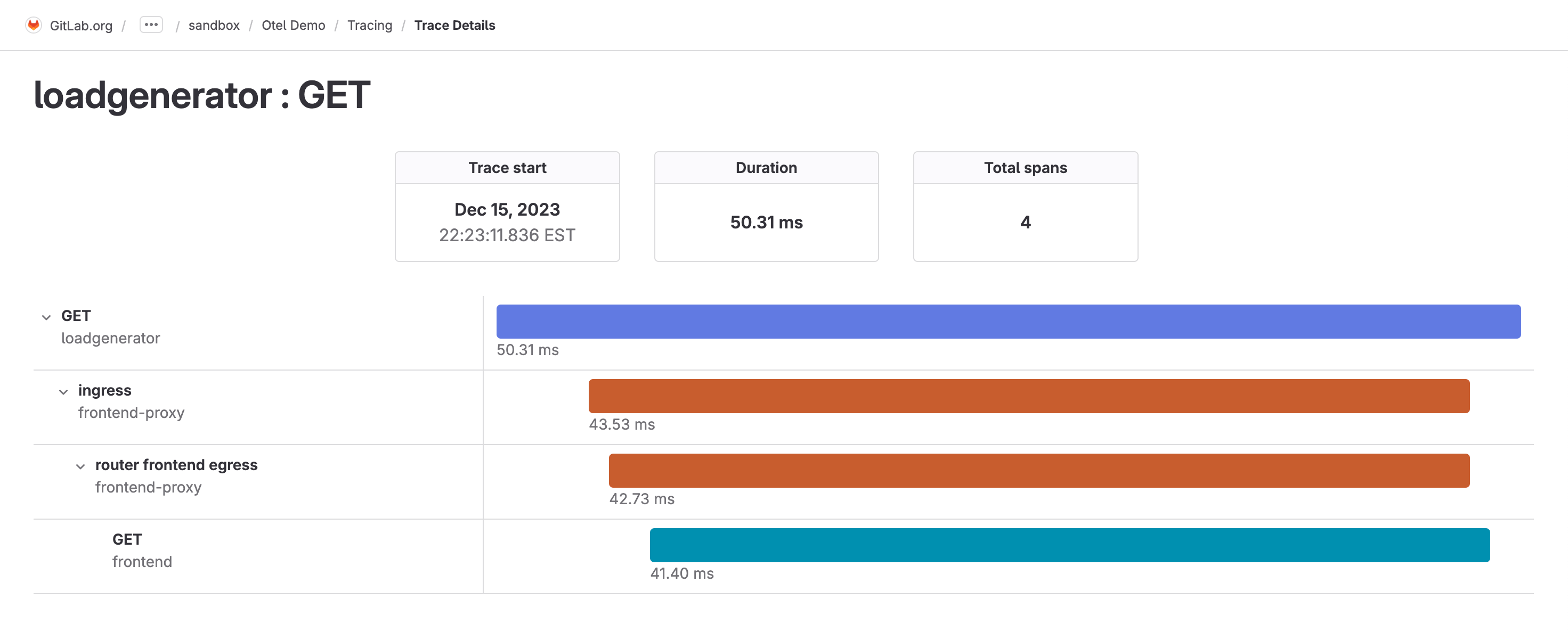

    The trace details page and a list of spans are displayed.
    tracing details

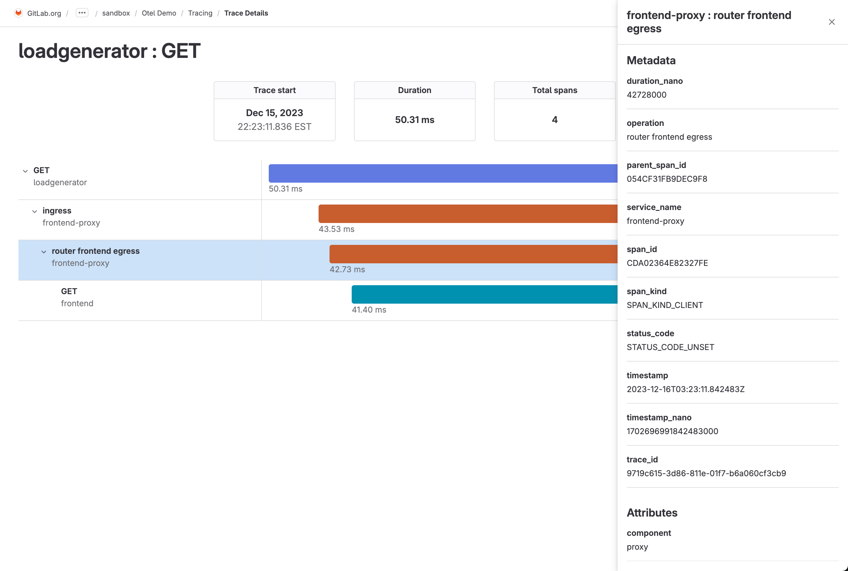

  4. Optional. To view the attributes for a single span, select it from the list.
    tracing drawer
