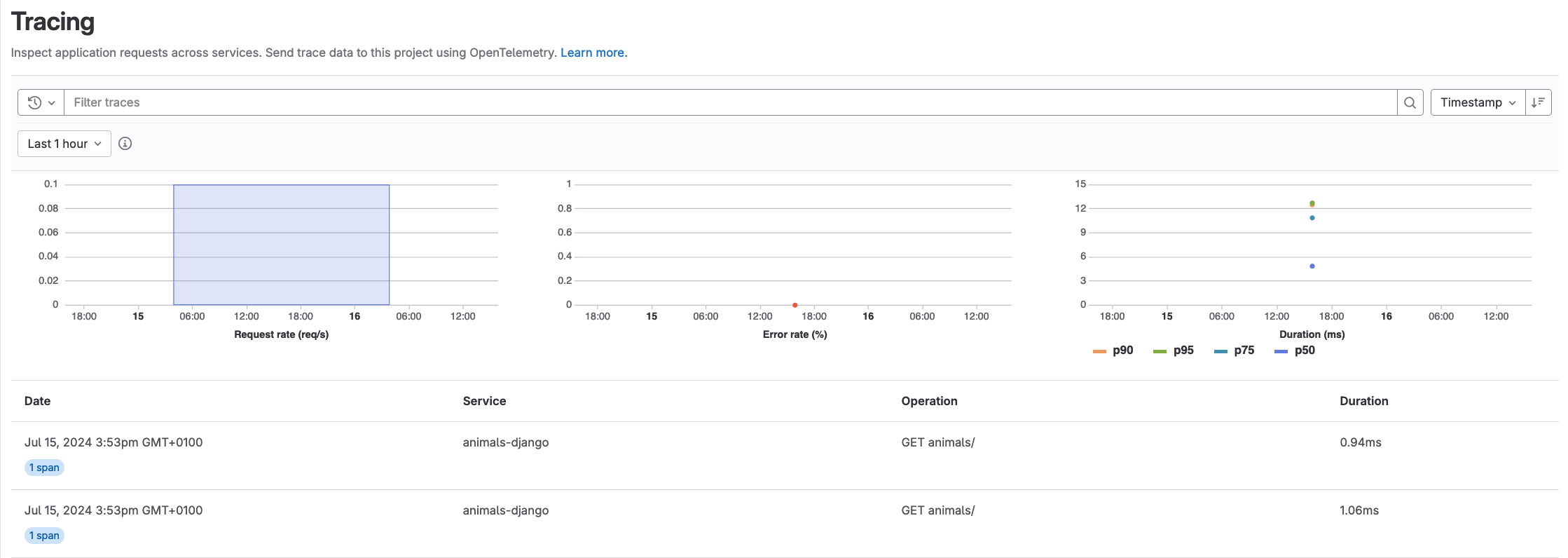

  1. To start collecting traces, restart the Django server. After refreshing /animals a few times, you should see traces in the GitLab UI.
    Django traces

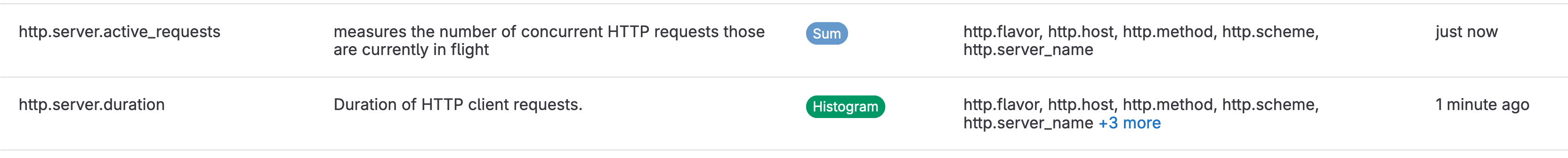

  2. Optional. Django will also export certain metrics by default to GitLab, but custom metrics are supported too. For example, to increment a counter metric every time a page is loaded, add the following code:
    meter = metrics.get_meter("default.meter")
     work_counter = meter.create_counter(
         "animals.viewed.counter", unit="1", description="Counts the number of times the list of animals was viewed"
     work_counter.add(1)
Django metrics
