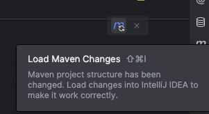

  2. Update dependencies by selecting Update Maven Changes:
    Maven changes update UI

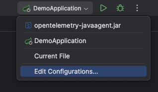

  1. From the upper-right menu, select Edit Configurations:
    Edit configuration

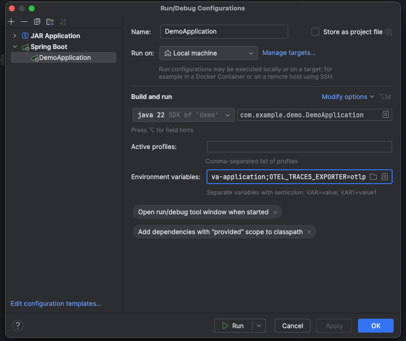

  2. In the configuration menu, select the icon in the Environment Variables field.
    Configuration menu
  3. Add the following set of environment variables, replacing {{PATH_TO_JAVA_AGENT}}, {{PROJECT_ID}}, {{PROJECT_ACCESS_TOKEN}} and {{SERVICE_NAME}} with the correct values. If using GitLab Self-Managed, replace gitlab.com with your GitLab Self-Managed instance hostname.
    • JAVA_TOOL_OPTIONS=-javaagent:{{PATH_TO_JAVA_AGENT}}/opentelemetry-javaagent.jar
    • OTEL_EXPORTER_OTLP_ENDPOINT=https://gitlab.com/api/v4/projects/{{PROJECT_ID}}/observability
    • OTEL_EXPORTER_OTLP_HEADERS=PRIVATE-TOKEN\={{PROJECT_ACCESS_TOKEN}}
    • OTEL_EXPORTER=otlphttp
    • OTEL_METRIC_EXPORT_INTERVAL=15000
    • OTEL_SERVICE_NAME=example-java-application
  4. Restart the application and reload the page at http://localhost:8000 a few times.
