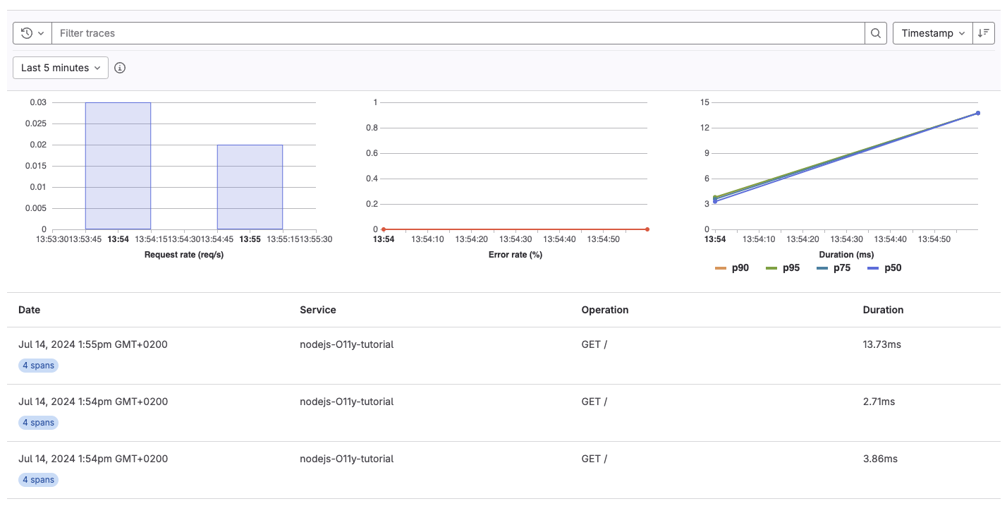

  3. In the nodejs-O11y-tutorial project, on the left sidebar, select Monitor > Traces. If everything is working correctly, you should see a trace for each request.
    Metrics UI
