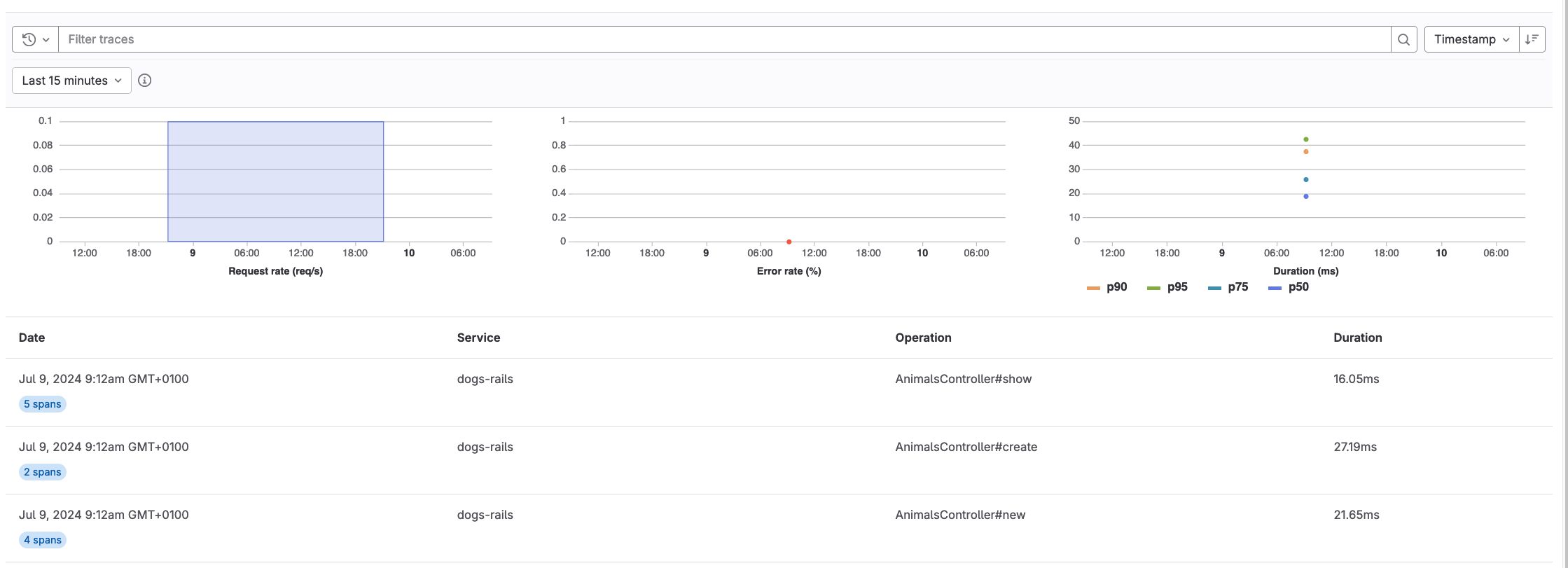

  3. In the animals project, on the left sidebar, select Monitor > Traces. If everything is working correctly, you should see a trace for each controller action.
    Metrics UI

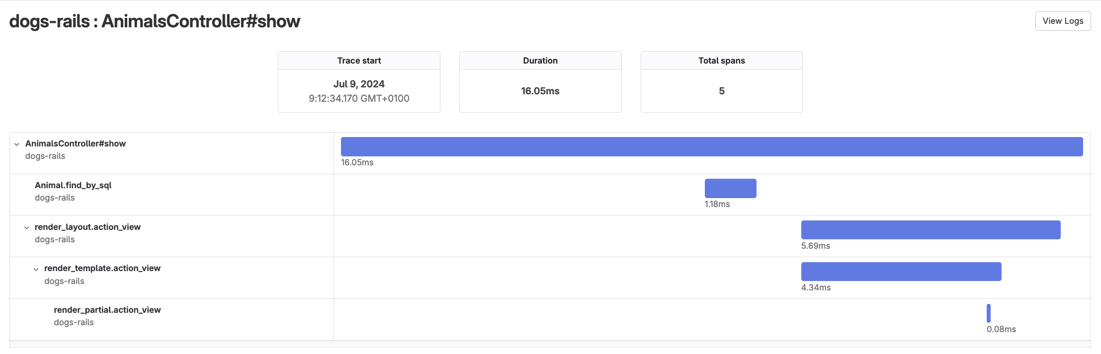

  4. Optional. Select a trace to view its span.
    Traces UI
