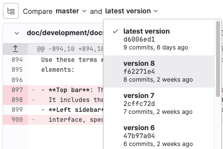

View diffs between commits
To view the changes between previously merged commits:
On the left sidebar, at the top, select Search GitLab ({search}) to find your project.
Select Code > Merge requests, then select your merge request.
Select Changes.
By Compare ({file-tree}), select the commits to compare:
If you selected to add previously merged commits for context, those commits are also shown in the list.
