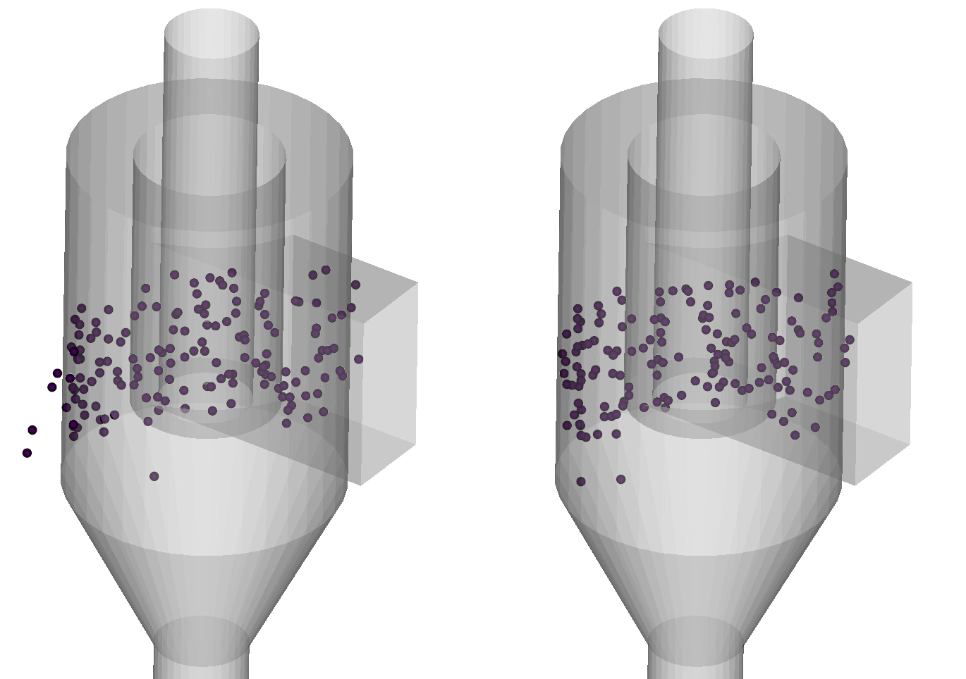

13.5.2. How to avoid particles going through solid walls in DEM simulations?
This is a common issue that arises when particles are too soft. Increasing the spring stiffness (kn and kn_w) typically helps resolve the issue.
Figure 13.2 Left: Soft particles (kn=kn_w=100 N/m) going through the cyclone wall. Right: Harder particles (kn=kn_w=1000 N/m) bouncing off the wall.
The spring stiffness can be adjusted in the Solids>DEM pane:
Figure 13.3 Spring stiffness settings in the GUI
Other possible reasons DEM particles may go through the wall:
Missing facets from the STL files: If the STL file is not waterproof, particles can go through the holes. The STL file must be inspected and corrected to fix this issue. The STL file should also not have facets with an angle smaller than the facet angle tolerance (Mesh> mesher pane).
DEM solids time step is too large. If the DEM solids time step is too large, collisions may be missed and particles can go through the wall. Increasing the spring stiffness will automatically reduce the solids time step, but it may be necessary to increase the DEM time step factor (Solids>DEM pane). It is recommended to not lower the DEM time step factor below the default value of 50.

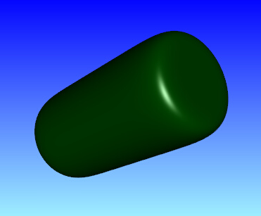

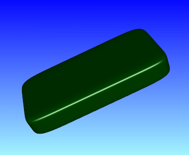

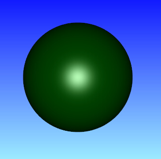

a |
b |
c |
m |
n |
shape |
view |
0.003 |
0.003 |
0.003 |
2.0 |
2.0 |
sphere |
0.003 |
0.001 |
0.006 |
2.0 |
2.0 |
ellipsoid |
0.003 |
0.001 |
0.006 |
8.0 |
8.0 |
cuboid |
0.003 |
0.003 |
0.006 |
2.0 |
8.0 |
cylinder |

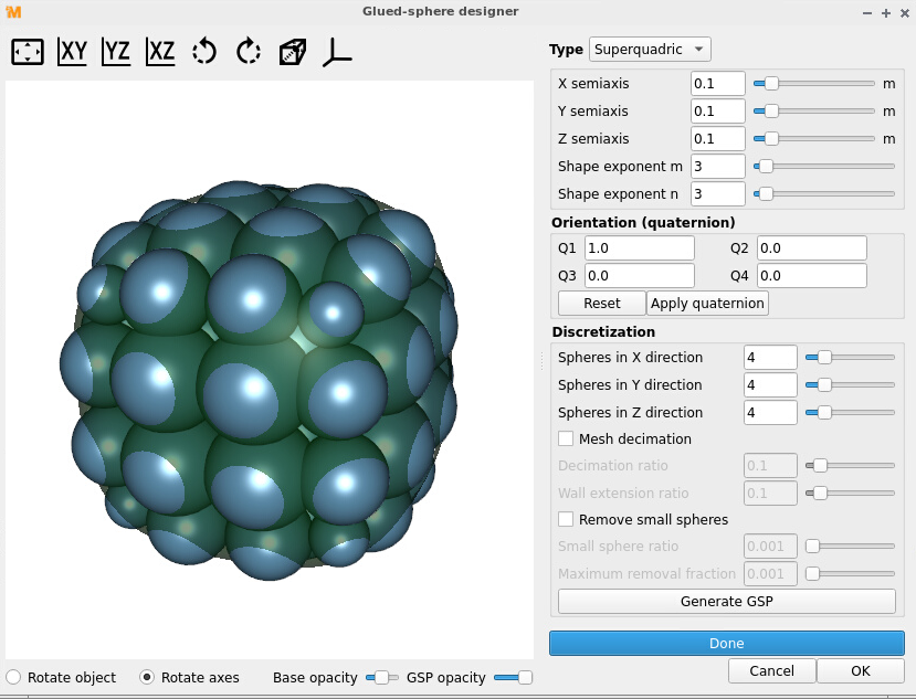

The glued sphere is an assembly of small spheres that approximates the shape of a non-spherical particle. It is obtained by discretizing the base shape into spheres through an algorithm controlled by a few parameters.
The real particle geometry can be defined either as a supequadric shape, using the same parameters as the SQP model \(a, b, c, m, n\), or by importing an STL file.
To define the glued-sphere configuration for a given solids phase, click on the “Glued-sphere designer” button (Solids> Material pane). A new interactive widget will pop up, where the glued sphere parameters can be specified. By default, a cuboic with round edges is defined.
First, define the type of geometry input: Superquadric or STL file. For a superquadric geometry, enter the X, Y, Z semi-axes, and m, n exponents. If selecting an STL file, select “Choose STL file” to import the STL file. A preview of the base shape will be shown on the left viewport.
If needed, the base shape’s orientation can be modified using quaternions. Click “Apply quaternion” to apply the rotation or “Reset” to use the original orientation.
Next, the volume discretization must be specified. Enter the number of spheres in X, Y, and Z directions. Increasing the number os spheres will result in a better shape approximation, but long run-time. It is recommended to use the smallest number of spheres possible to avoid prohibitively long run time.
For complex or fine STL files, the mesh can be decimated (simplified) to speed up the glued sphere generation. Check the “Mesh decimation” box and provide a non-zero decimation ratio. Using a large decimation ratio may result in a loss of geometric details.
The glued sphere generation uses a bounding box to determine the extent of the geometry. The bounding box can be slightly extended to help the intersection algorithm by specifying a non-zero wall extension ratio.
Sometimes the algorithm will generate some very small spheres. These can create stability issues in the contact force calculation and/or unnecessarily small solids time step. To control how small spheres can be removed from the assembly, check the “remove small spheres” box. Then specify the small sphere ratio. When a sphere’s volume is less than this ratio times the largest sphere volume, this small sphere will be considered for removal. Next, specify the Maximum removal fraction. This will remove all small spheres identified in the previous step until their combined volume reaches the maximum removal fraction times the baseline particle volume.
Once all the parameters have been specified. press the “Generate GSP” button. The progress bar will update while the algorithm generates the glued sphere. Once generated, the glued sphere will be displayed in the viewport. The opacity of the base shape and the GSP can be adjusted for better visualization.
Figure 13.6 Glued-sphere designer

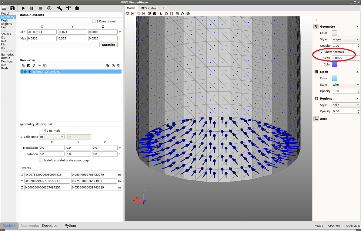

13.8.1. How to verify/flip STL file facet normals?
When using an STL file to define the geometry, a normal vector is associated with each facet (triangle). The direction in which the normal vector points indicates the fluid region. It is important to verify the normal vectors points in the desired direction before running the simulation.
To show the normal vectors in the Model view, expand the geometry view settings on the right and check “Show Normals”. It may be necessary to adjust the scale to get a better view. The figure below shows an example of a cylinder with vectors pointing towards the interior region of the cylinder. This will correspond with an internal flow simulation where the fluid region is located inside the cylinder and the outside region is not part of the simulation.
Figure 13.7 Displaying STL normals, internal flow
If the normal vectors are not pointing in the correct direction, the normals can be flipped by checking the “Flip normal” box for any selected stl file. To model an external flow using the same geometry as above, flip the normals and the change will be reflected in the Model view (see figure below). Now the normals points towards the outside of the cylinder, and the region inside the cylinder will not be part of the computation.
Figure 13.8 Flipping STL normals to model an external flow
