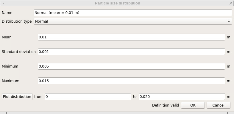

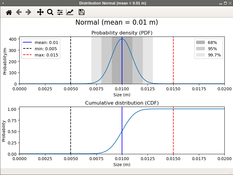

Define a Normal psd:
Name:
Normal (mean = 0.01 m)(use a descriptive name).Distribution type:
NormalMean:
0.01Standard deviation:
0.001Minimum:
0.005Maximum:
0.015Plot from 0 to
0.020
Figure 3.2 Normal PSD definition.

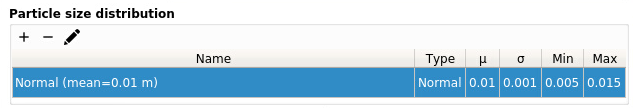

Plot the psd by clicking on
Plot distribution. Verify the plot corresponds to the parameters.
Figure 3.3 Normal PSD plot.
Click
OK.
We now have a PSD that we can use in initial or mass inflow boundary conditions.

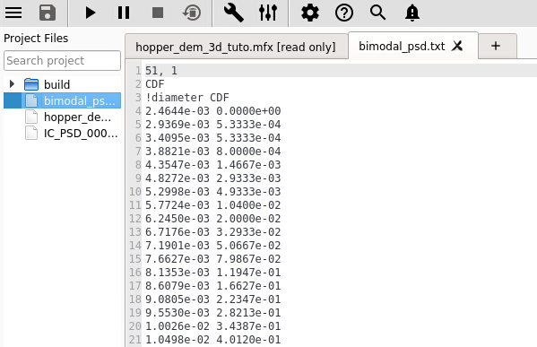

Besides the Normal and Log-normal psd’s, we can also use custom distribution from a text file. It can be edited through any text editor including the GUI built-in editor. The PSD custom file is organized as follows:
The figure below shows an example of a custom PSD file. Only the first few lines are shown.
Figure 3.4 Example of a Custom file used to define a Particle Size Distribution.

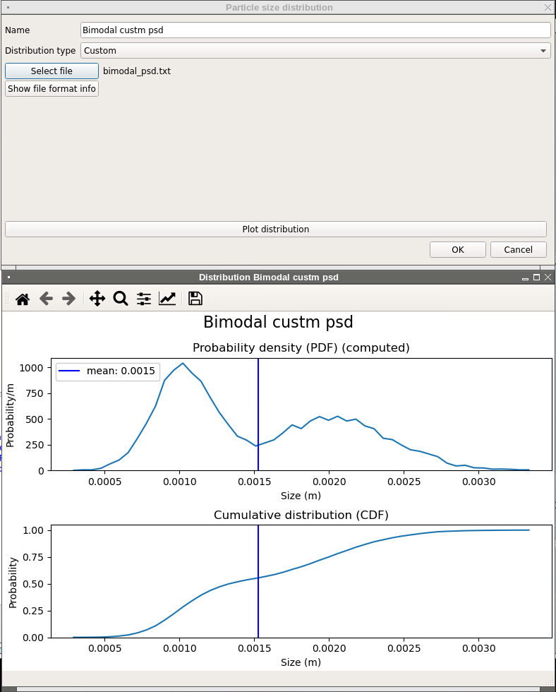

In the Solids>DEM pane, Click the
button in the Particle size distribution table, and define a custom psd:
Name:
Bimodal psd(use a descriptive name).Distribution type:
CustomSelect file: Choose
bimodal_psd.txtin the project directory.Click
Plot distribution.
Figure 3.5 Custom PSD.
Run the simulation and visualize particles.
Notice that we are not able to seed particles with the requested solids volume fraction of 0.1. This is because the lattice spacing is based on the largest diameter in the psd.
Change the spacing to

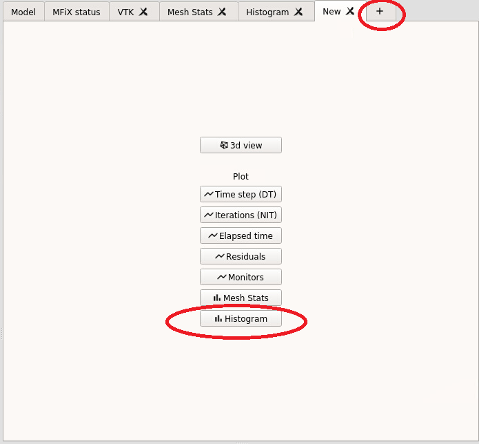

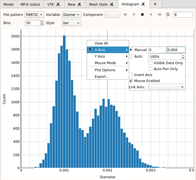

0.02, run the simulation and verify that we get a volume fraction of 0.1 (or near 0.1).While the simulation is running, we can visualize a histogram showing the particle size distribution. Open a new visualization viewport by clicking on the
sign on the right-most tab and select the histogram view. This will setup a histogram plot. Users can change the file to view, the variable, number of bins and style (lines or bars). To adjust the scale, right-click on the view and enter the axis limits or have them be automatically updated based on data.

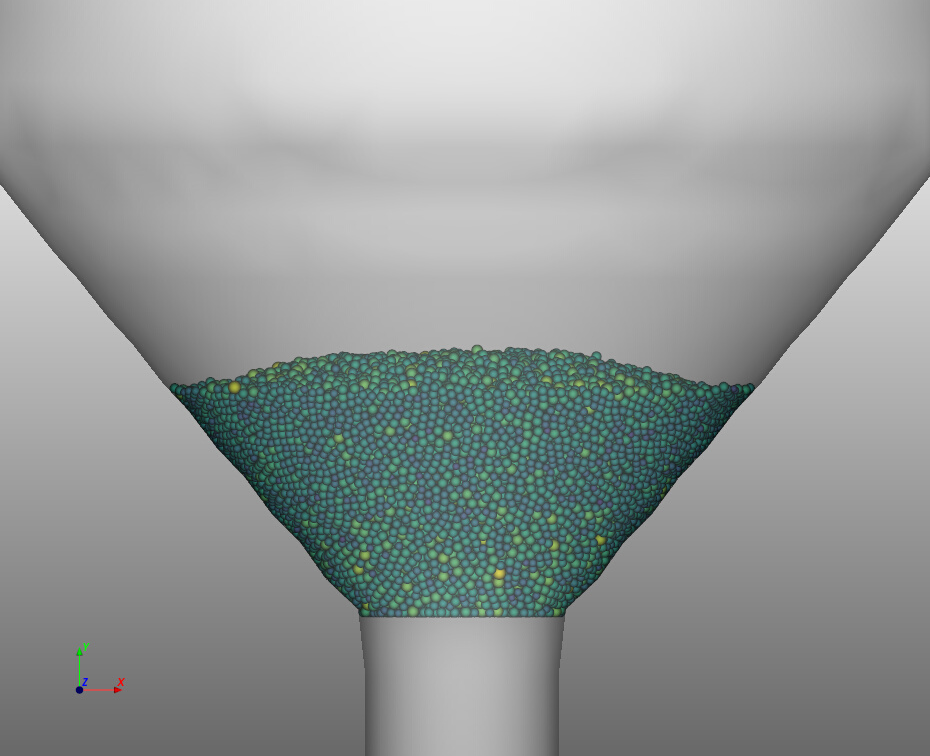

Runpane, setStop timeto 1.0 seconds.Run the simulation. You should see the initial configuration shown below:
Figure 3.8 Example of a DEM initial condition using particle_input.dat version 2.0.
