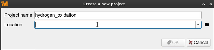

On the main menu select

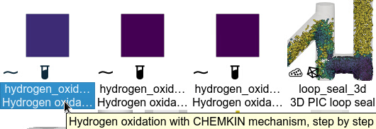

New project.Open the project
hydrogen oxidation with CHEMKIN mechanism, step by step.
Choose the location for your working directory and click
OK.

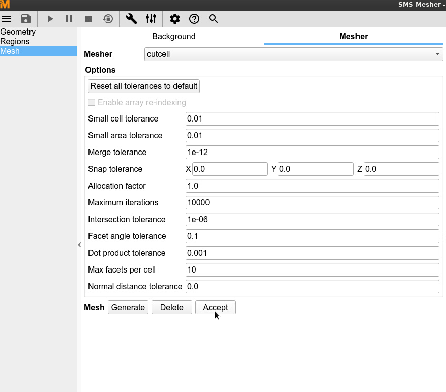

3.11.2. Generate mesh
On the Mesher pane:
Click
Generateto generate the meshClick
Acceptto accept the mesh, and switch to the Modeler tab (bottom left of GUI).

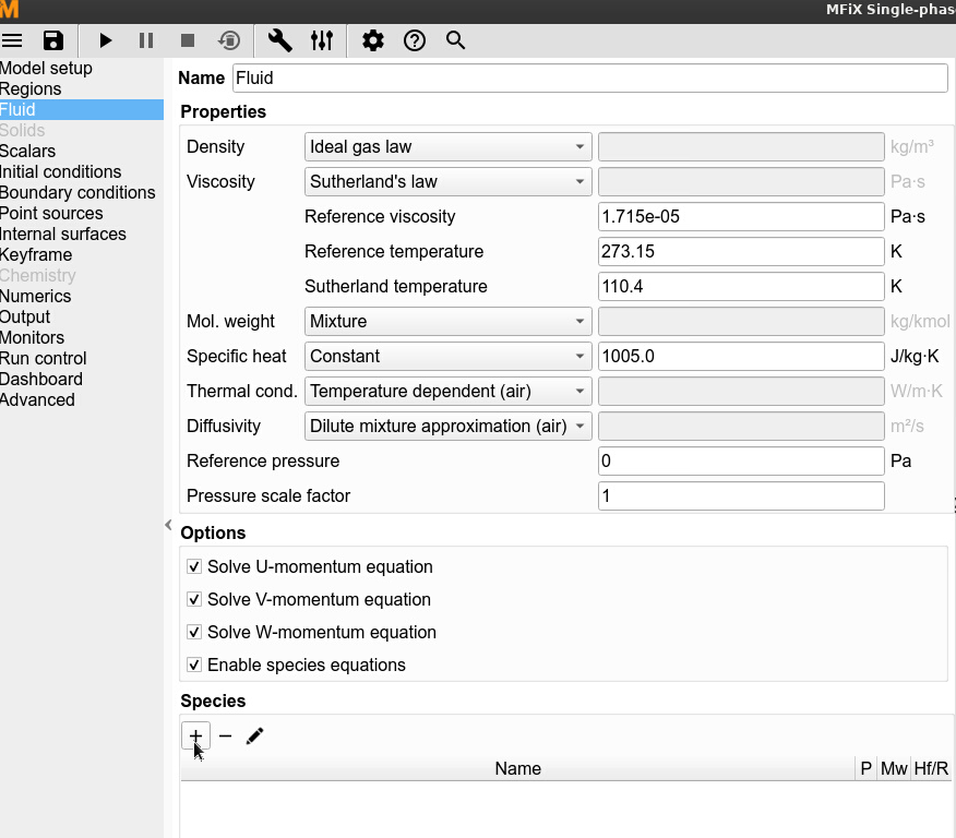

3.11.3. Import species for fluid phase
On the Fluid pane:

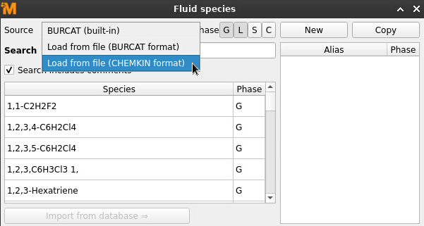

Select

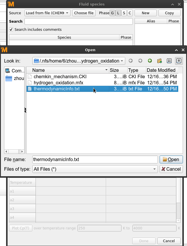

Load from file (CHEMKIN format)inSourceof the popup window
Click
Choose file, choose “thermodynamicInfo.txt” in the popup window, and clickOpen.
After importing the file, the species defined in the file will show in the window.
Select all the species (click on first species “AR” and drag down) and click
import from databaseto import all species. ClickDone.
Note
Users have the flexibility to select the required species for their case from the provided list. If a species is not defined in the CHEMKIN file, users can import it from the built-in Burcat database or an external Burcat file as well.

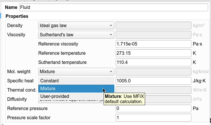

For reacting cases, constant specific heat capacity is not allowed. Change it to “Mixture” in “Properties”.

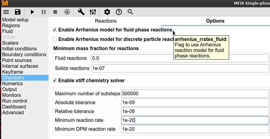

On the Chemistry pane, Options sub-pane:
Check the
Enable Arrhenius model for fluid phase reactionscheckboxChange the
Minimum mass fraction for reactionsforFluid reactionsto 0 to consider all species with mass fraction larger than 0 in the reactionsCheck the
Enable stiff chemistry solvercheckboxChange the
Absolute tolerance,Relative toleranceandMinimum reaction ratein stiff solver to be 1e-09, 1e-08 and 1e-20.
Note
Users can change the minimum mass fraction for reactions and the parameters for stiff solver based on the accuracy requirement of their cases.

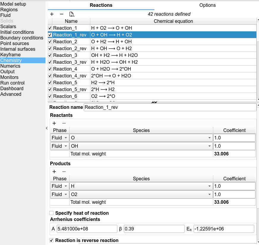

On the Chemistry pane, Reactions sub-pane:

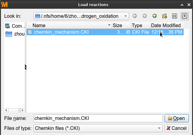

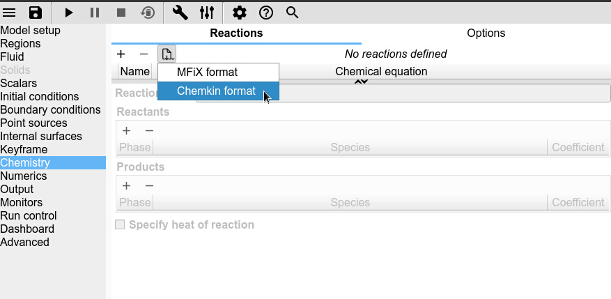

Click
Load reaction definitions from text fileand selectChemkin formatSelect the mechanism file “chemkin_mechanism.CKI” in the popup window. Click
Open.
Then all the reactions with all the information will be imported

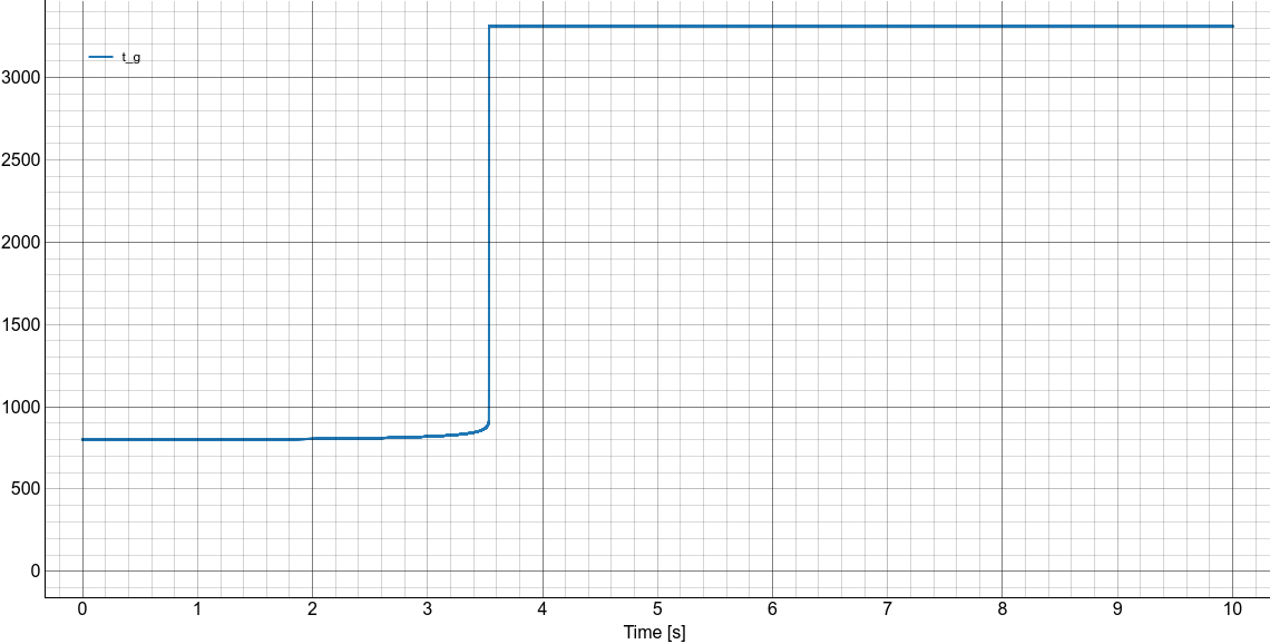

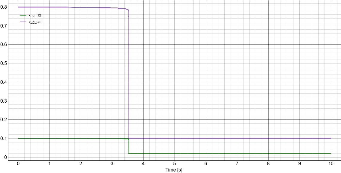

This tutorial simulates the oxidation of H2 in a batch reactor. Users should expect to see consumption of H2 and O2 and a temperature increase from the exothermic reaction.
next to the Model tab
Select

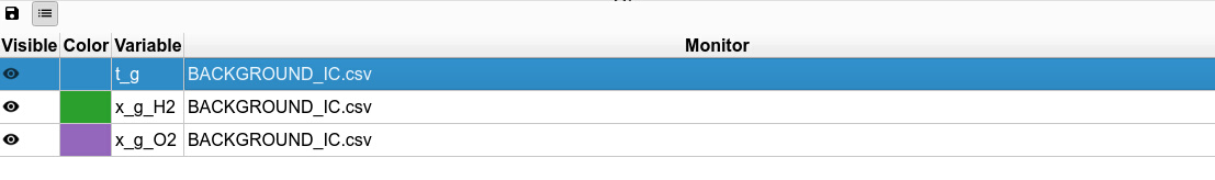

Monitorsto view the results.On the
Monitorsresults tab, the visibility of the variables can be controlled with the menu under the plot.
Hide the gas temperature by unclick the
for variable t_g. The following plot with the transient changes of the mass fraction of H2 and O2 will be shown.
Hide the gas species by unclick the
for variables x_g_H2 and x_g_O2. The following plot with the transient change of the gas temperature will be shown.
