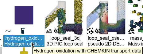

New project.Open the project
hydrogen oxidation with CHEMKIN transport data.

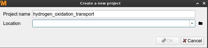

Choose the location for your working directory and click
OK.

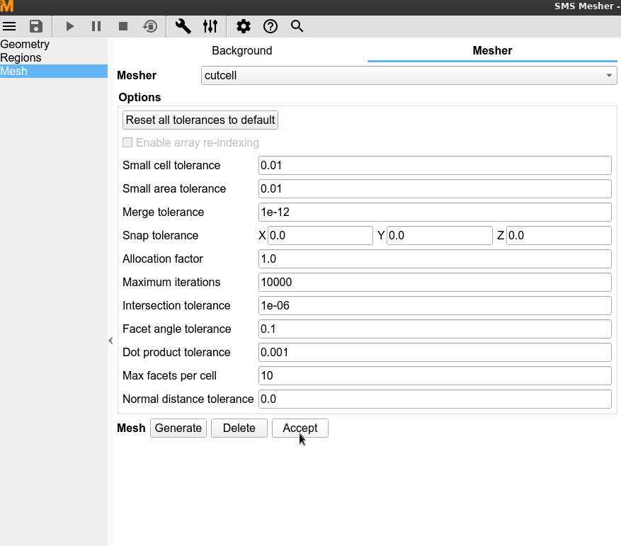

On the Mesher pane:
Click
Generateto generate the meshClick
Acceptto accept the mesh, and switch to the Modeler tab (bottom left of GUI).

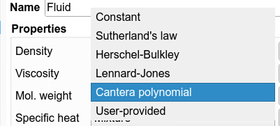

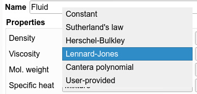

Click the models for Viscosity. There are six different models.
Lennard-JonesandCantera polynomialwill be discussed in this tutorial, which use the transport data.

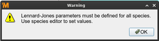

Lennard-Jonesfor Viscosity. The following warning will popup to remind users adding the required parameters. ClickOK.

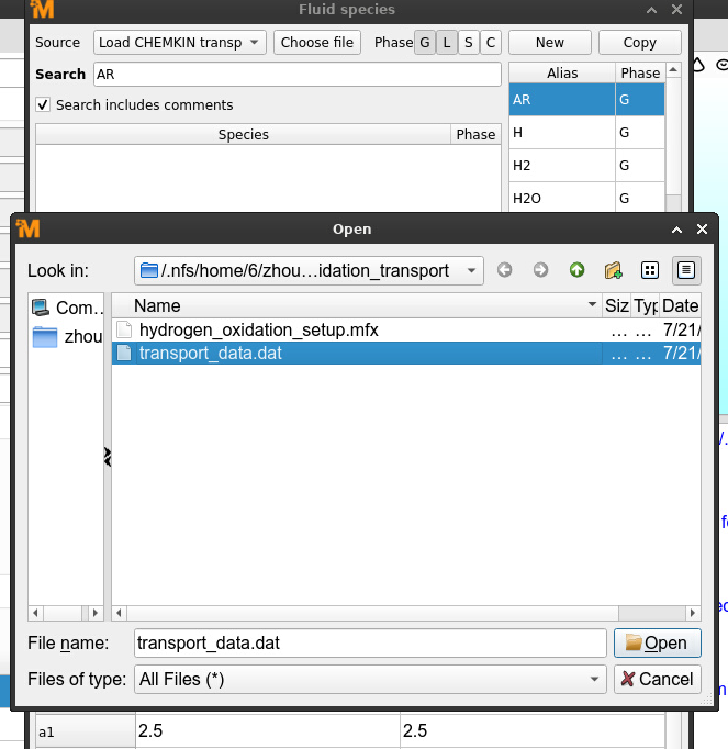

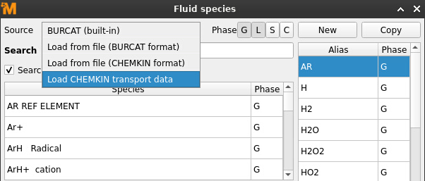

Import them from an external file, which has the transport data in CHEMKIN format. In the transport file from CHEMKIN, species name following with its molecular shape, Lennard-Jones potential well depth, Lennard-Jones collision diameter, dipole moment, polarizability and rotational relaxation collision number at 298K are provided.
The following steps show how to import the file for transport data
Select
Load CHEMKIN transport datainSourceof the popup window
Click
Choose file, choose “transport_data.dat” in the popup window, and clickOpen.
After importing the file, the Lennard-Jones parameters will be added automatically in the corresponding box
Click
Doneto close the popup window and add other settings
Note
Multiple transport files can be imported. The data will be overwritten based on the last imported file if species is defined in multiple files.

Select
Cantera polynomialfor Viscosity.

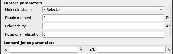

Select one of the species in the
Speciespane. Double click to edit, or click the edit button. The boxes to add the transport data for this model are shown in the popup window. The default values of dipole moment, polarizability and rotational relaxation of 0 will be shown.
Similar to Lennard-Jones model, users have two options to add the parameters.
Add them in the box manually
Import them from an external file, which has the transport data in CHEMKIN format. Follow the same steps as Lennard-Jones model to import the file.

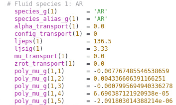

Only the molecular shape, dipole moment, polarizability and rotational relaxation need to be defined. The GUI will automatilcally compute the polynomial coefficients poly_mu_g using Cantera and save them into .mfx file.

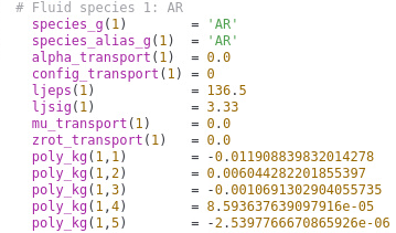

Only the molecular shape, dipole moment, polarizability and rotational relaxation need to be defined. The GUI will automatilcally compute the polynomial coefficients poly_kg using Cantera and save them into .mfx file.

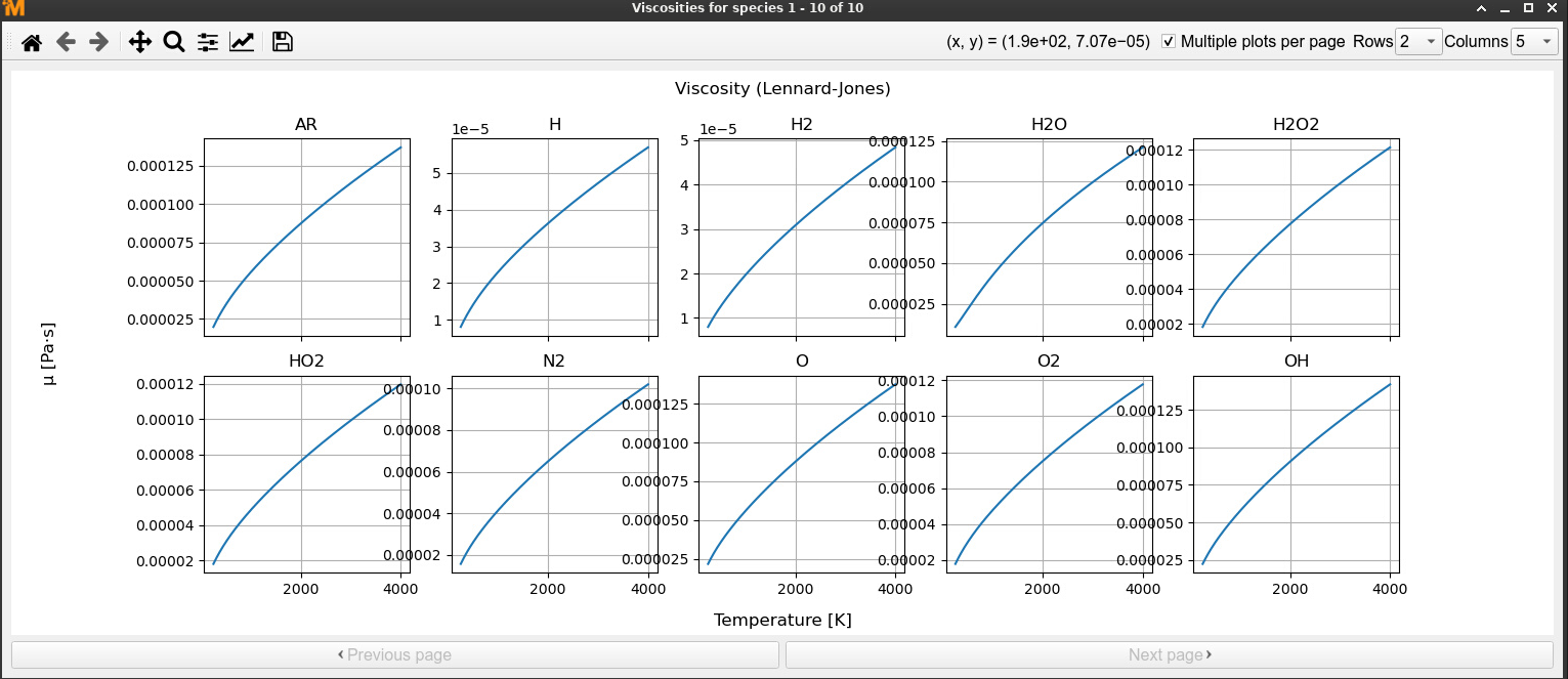

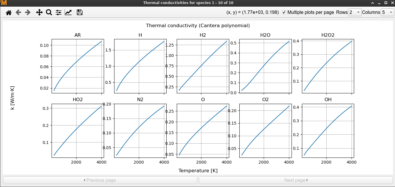

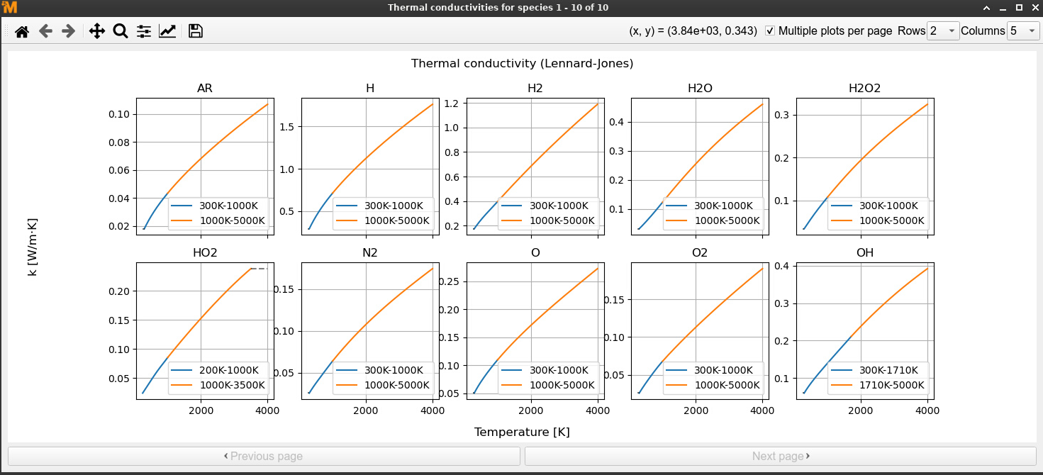

3.12.5. Plotting the viscosity and thermal conductivity of gas species
Users can plot the viscosity or thermal conductivity of each gas species as a function of temperature.
Select
thermal conductivtyorviscosityforplotat the bottom of the popup window.Click

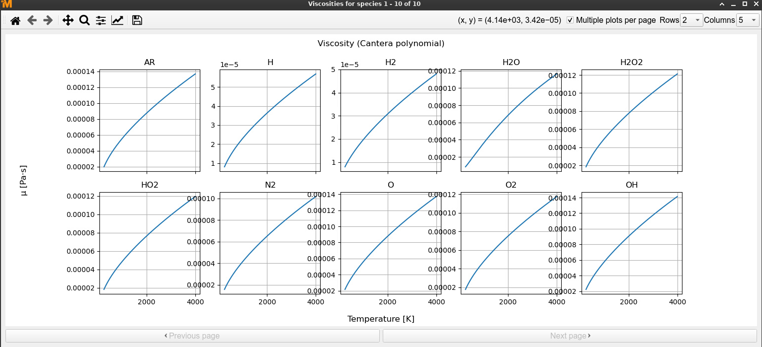

Plotto show the figures. Users can changes the number of plots in each page by changing the number of rows and columns at the top-right corner of the plot.
3.12.5.1. Viscosity and thermal conductivity with Lennard-Jones model
Note
There are two ranges for the thermal conductivity based on the common temperature of species from the thermodynammic data. It is because the thermal conductivity using Lennard-Jones model depends on the heat capacity of species, which has different coefficients at different temperature ranges.
3.12.5.2. Viscosity and thermal conductivity with Cantera polynomial model

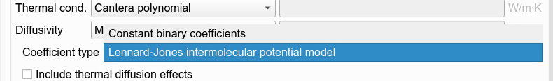

3.12.6. Using the transport data for the diffusivity model
The Lennard-Jones parameters can be used for the calculation of diffusivity as well.

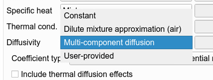

Select
Multi-component diffusionfor Diffusivity
Select
Lennard-Jones intermolecular potential modelfor Coefficient type
Add the required parameters in the popup window by adding them manually or importing an external file.
