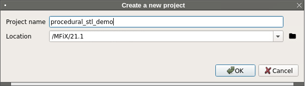

3.10.1. Create a new project
Create a new project by double-clicking on “Blank” template.
Enter a project name and browse to a location for the new project.
If you have not switched to SMS workflow, you will be prompted to switch. Accept SMS mode.

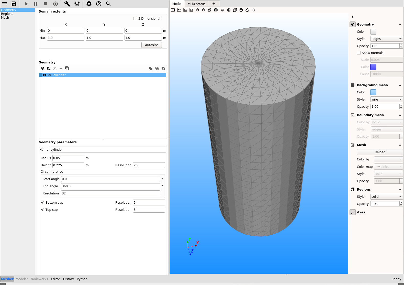

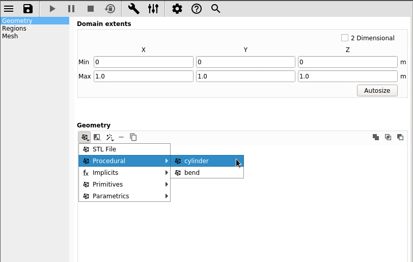

First, create a cylinder:
Go to the Geometry pane and click the button to add geometry:
Enter the cylinder’s parameters:
Radius =
0.05m, Height =0.225m, Resolution =20Start angle=
0deg, end angle =360deg, resolution =32Check the
Bottom capandTop capcheck boxes and set the resolution to5for both caps.

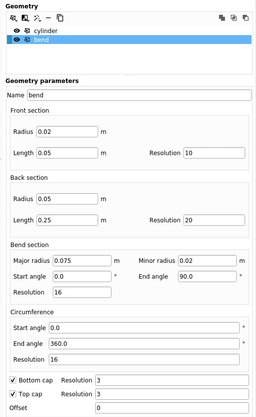

Next, create a bend:
Go to the Geometry pane:
Choose
Procedural > Bendas the geometry input (named “bend”).Enter the bend’s parameters:
Front section: Radius =
0.02m, Length =0.05m, Resolution =10Back section: Radius =
0.05m, Length =0.25m, Resolution =20Bend section: Major radius =
0.075m, Minor radius =0.02m, Start angle=0deg, end angle =90deg, resolution =16Circumference: Start angle=
0deg, end angle =360deg, resolution =16Check the
Bottom capandTop capcheck boxes and set the resolution to3for both caps. Leave Offset =0

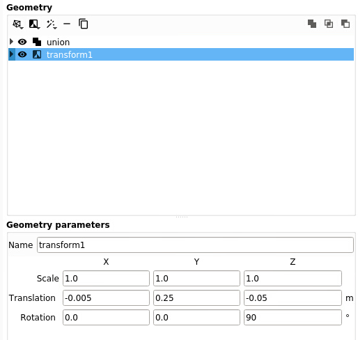

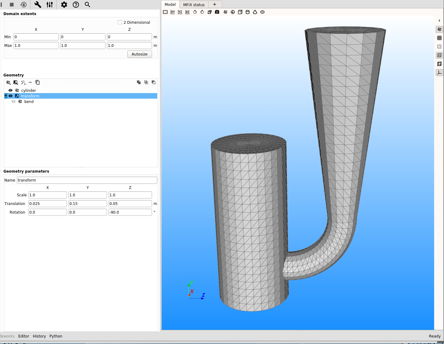

Rotate and translate the bend:

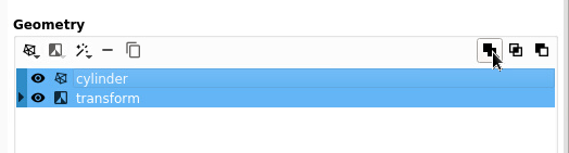

Combine the cylinder and the bend (union):

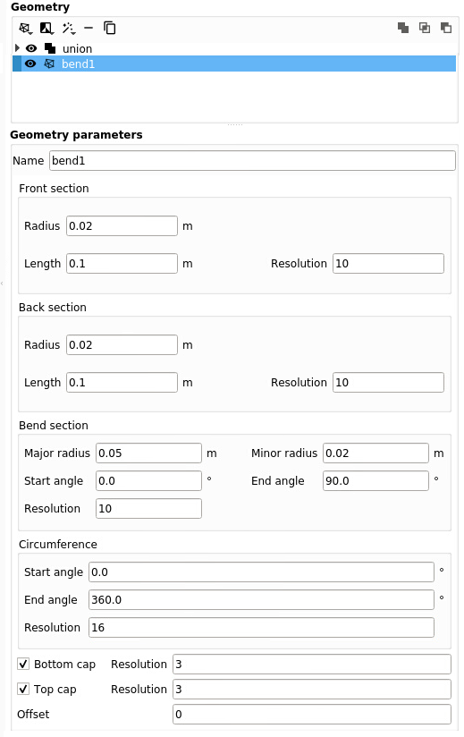

Procedural > Bendas the geometry input (namedbend1).Enter the bend’s parameters:
0.02m, Length =0.1m, Resolution =10Back section: Radius =
0.02m, Length =0.1m, Resolution =10Bend section: Major radius =
0.05m, Minor radius =0.02m, Start angle=0deg, end angle =90deg, resolution =10Circumference: Start angle=

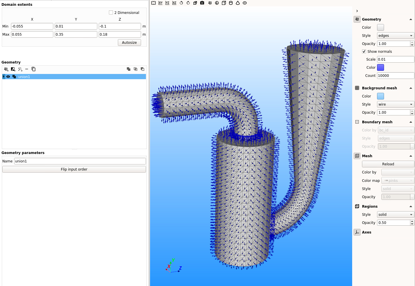

3.10.3. Check the geometry orientation

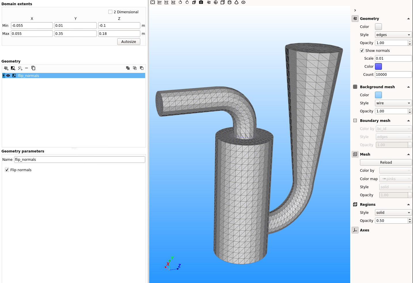

Visualize and flip the orientation (normal vectors) of the geometry:
In the model window, show the Geometry, hide the Background mesh, Hide the Regions (visibility is toggled by clicking on each icon). Set the Geometry style to
edges, opacity to 1.0, check theShow normalsbox, set theScaleto 0.01, setcountto 10,000 (to show all normals).
The normal vectors must point towards the fluid region (here towards the inside of the geometry). However we see that the normals point in the opposite direction (outwards the fluid region). This means we need to flip the normals to correct the orientation.
Select the
union1geometry,Add a filter:
flip normals. Now the vectors point towards the fluid region. The tips of the arrows are not visible, but we can see the origin (shown as a dot at the center of each face).

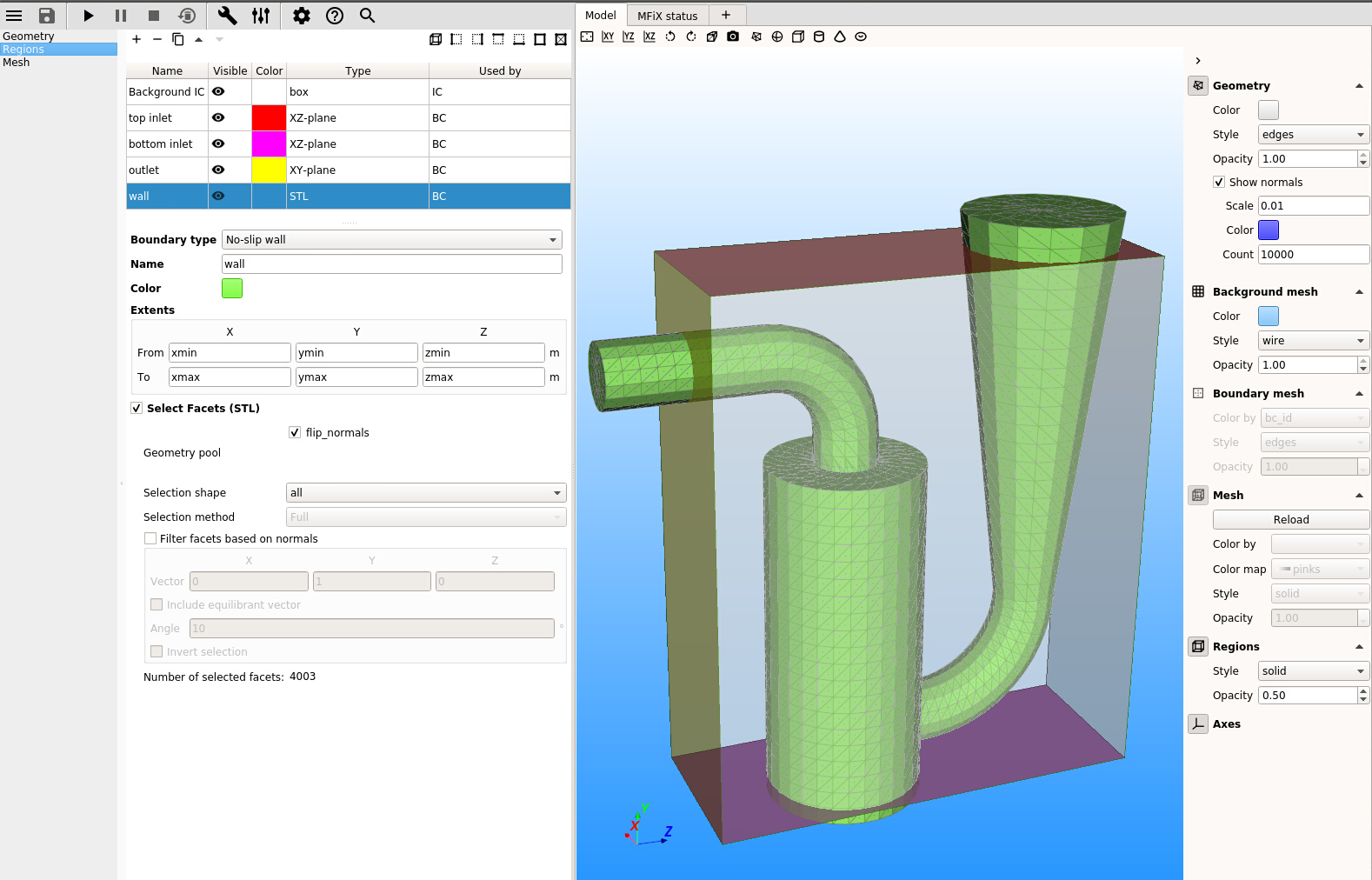

Click the
(all) button to create a new region that covers the entire domain to be used for the wall boundary condition.
Select
No-slip wallin theBoundary typedrop down menu.Enter a name for the region in the
Namefield (“wall”).Change the region color to green.
Check
Select facets (STL)andflip_normals, useallfor the selection method. You should see that there are 4003 facets selected.

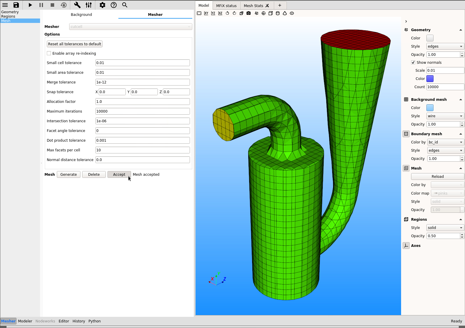

Go to the Mesh pane, Mesher sub-pane:
Set the Facet angle tolerance to
0.0deg. (The geometry unions have created elongated triangles we need to keep).Click
Generate.Look at the console output to verify the mesh generation completed successfully.
In the Model view, - hide the Geometry, Background mesh and Regions - show the Boundary_Mesh - set
Color bytobc_id, - setStyletoedgesand opacity to1.0.The Boundary_Mesh should look like a closed surface with colors matching the boundary conditions regions.
After inspection, the mesh is deemed acceptable and we can move to setting up the simulation (Solver mode). Click Accept. This will unlock the Modeler tab.

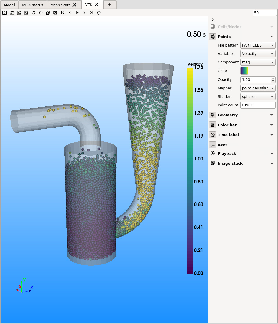

3.10.16. View results
next to the Model tab.
Click the
3D viewbutton to view the vtk output files.On the
VTKresults tab, the visibility and representation of the*.vtkfiles can be controlled with the menu on the side.
