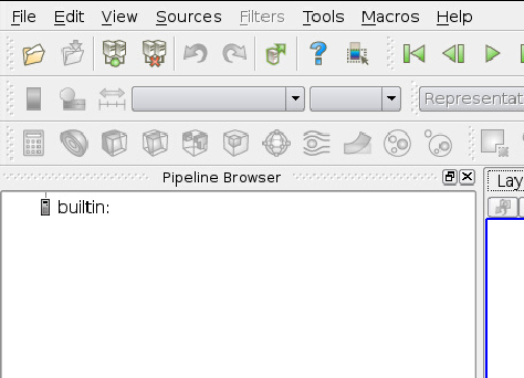

Figure 7.1 Click on File icon file, or File > Open

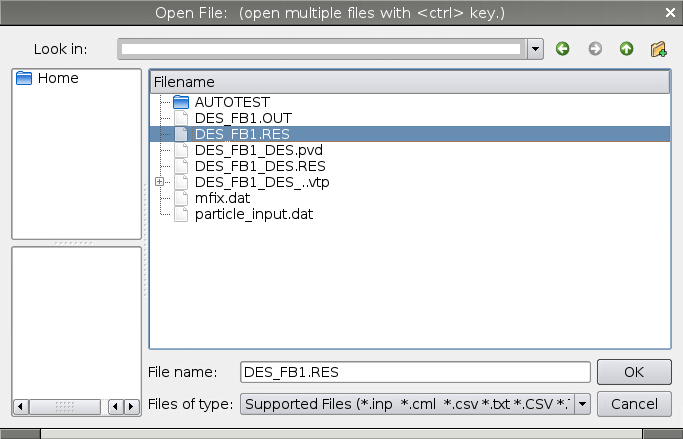

Fluid field results for a standard structured mesh are displayed in ParaView by loading the .RES file. To open the RES file, click on File/Open (Figure 7.1), and navigate to your run directory.
Select the DES_FB1.RES file (Figure 7.2). Do NOT load the DES restart file (DES_FB1_DES.RES). This binary file is not supported by any visualization software. It only contains restart data and will likely cause ParaView to crash if loaded.

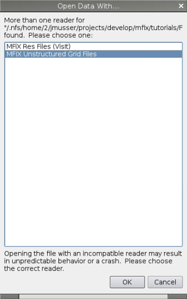

Newer versions of ParaView require that you select the appropriate reader. Choose to open the data with “MFiX Unstructured Grid Files”. (Figure 7.3)
paraview visualization
Figure 7.3 Select “MFiX Unstructured Grid Files”

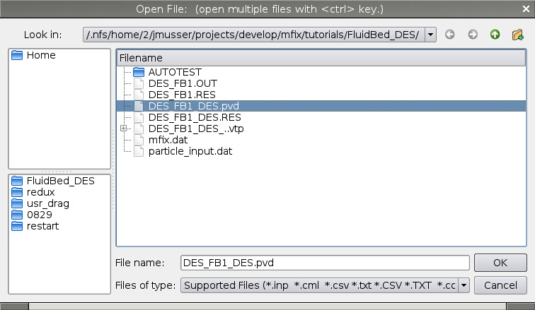

Figure 7.4 Open DES_FB1_DES.pvd
DEM and PIC particle simulation data is loaded into ParaView by opening the .pvd file. (Figure 7.4)

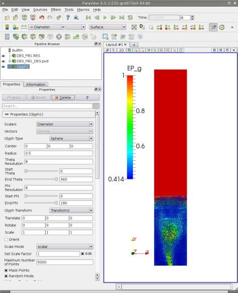

Particles are shown by applying a glyph to the dataset. To apply a glyph filter, either:
  • Filters > Alphabetical > Glyph
  • or click the glyph icon.
Commonly, particle data is represented using:
  1. Sphere glyph type and
  2. Scalar scale mode with a scale factor of one.
Note that these screenshots may appear differently depending on your version of ParaView.
