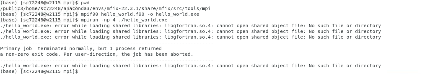

I have already built DMP solver successfully. Then I tried to run MPI jobs with the standard MPI wrapper command, and the error happened:
how can I fix this error?

I’m not sure exactly what the issue is but libgfortran.so.4 is quite old, most systems have libgfortran.so.5. I would try updating the Fortran compiler and/or OpenMPI installation.
Can you build and run the MPI hello_world example?
share/mfix/src/tools/mpi/hello_world.f90
If that succeeds, please run mfixversioninfo and paste the output here. Thanks.
Hello cgw,
I have tried to run the MPI example, and yes, it also reported the same error. My MFIX is installed in a commercial remote computing server set. I’m not sure if there’s something wrong with my procedure.
load openmpi:
It looks like their is an incompatibilty between the mpi/openmpi/4.1.1-gcc7.3.0 module on your server and the libgfortran in Anaconda which is libgfortran.so.5. Note that gcc7 is several years old.
Suggestion: Either get your support people to update the openmpi module, or, probably easier, don’t activate that module at all and rather get your Fortran compiler and openmpi from Conda:

Thanks @cgw ,I have connected administrator, and he helped me to solve this problem.
I need to load gcc after openmpi. I don’t know why but it works. ![]()
module load mpi/openmpi/4.1.1-gcc7.3.0
module load gcc/7.3.-wzm
