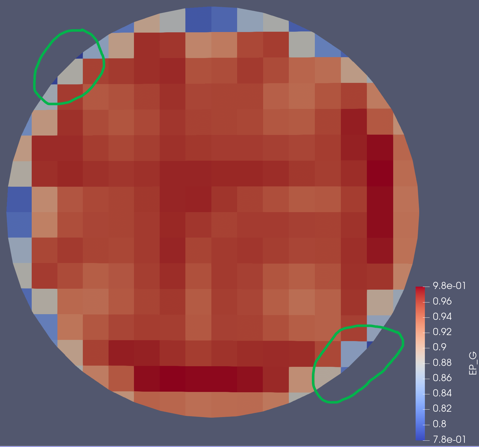

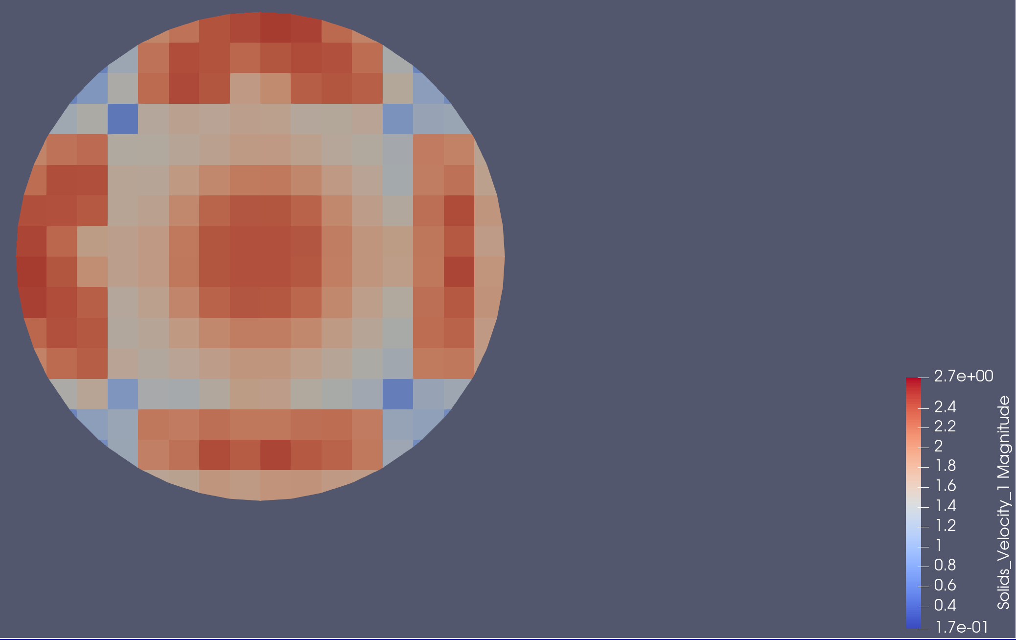

I am using MFiX 22.3 GUI (Ubuntu 18.04.5 with GNU 7.5.0) with cartesian cut cell coordinates for modelling vertical transport with 3D TFM. I find solids accumulating in the smaller cut cells and it would appear unphysical.
Below are paraview screenshots (showing the pipe outlet cross-section at 2s process time) for the 1 m long pipe case for which I have attached the bug report.
