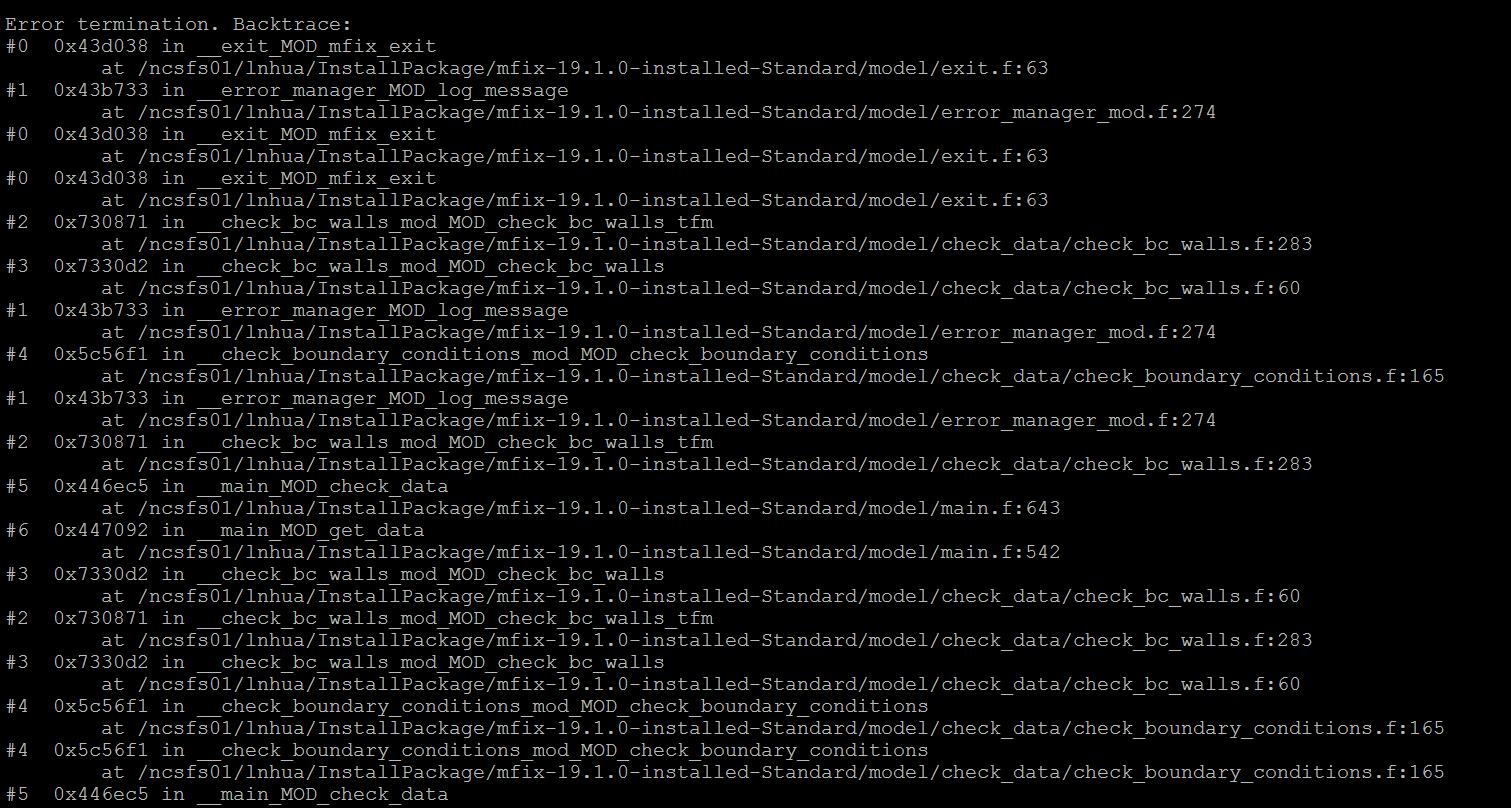

I run TFM for a liquid-solid system with the BC setting like this
The solver of MFIX-18.1.1 could run mfix.dat successfuly. But when I tried it with MFIX-19.1.0, the error appeared:
So there is something different for BC setting between these two versions? Thank you.
can you post your *.mfx file?
You shouldn’t be using J/J boundary conditions with cut cells. This use isn’t supported.
Thank you. I have tried the BC setting without JJ boundary condition in case of cut-cell. It works.
Hi Justin, I have solved this problem. Thank you.
But for MFIX-18.1.0, I can set FSW BC with JJ BC when using cut cells for TFM simulation. MFIX-19.1.0 does not support this again.

In any official version of MFiX, JJ boundary has not been implemented for cut-cell yet. Even you put all those key words (that work for regular cell) there, they do not have any effect.
