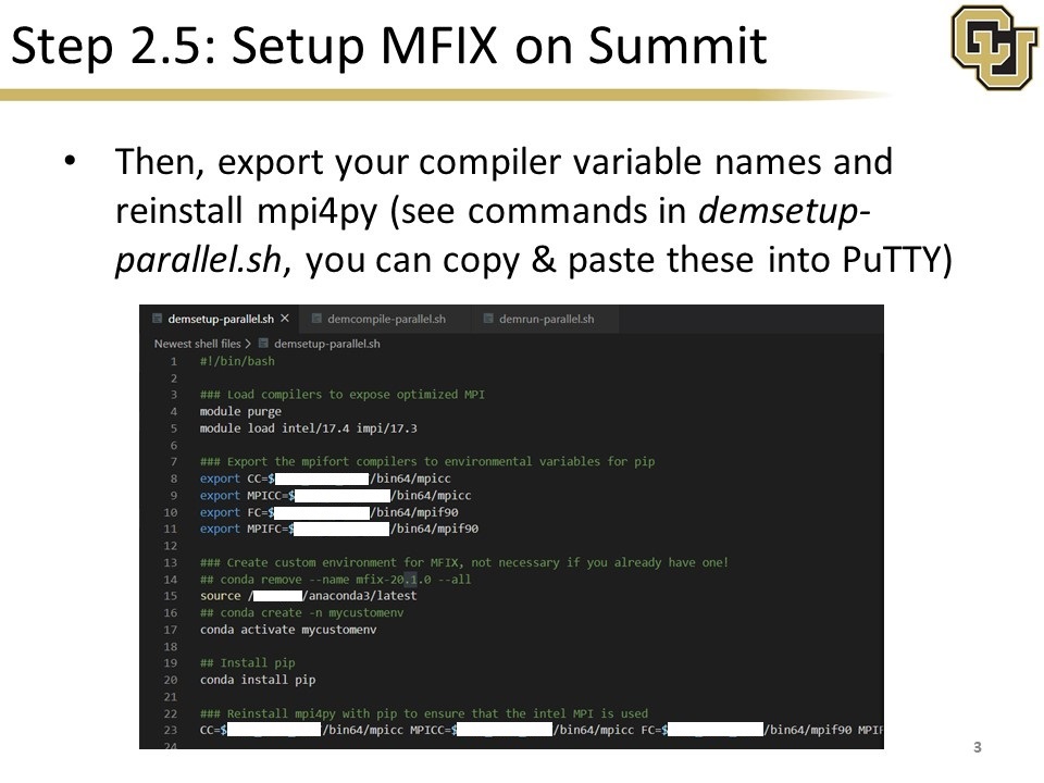

Yes, I did something very similar back in April! I made a pretty detailed tutorial for this with my university’s supercomputer, I’ll attach the relevant slides. Let me know if you have more questions. This tutorial is for configuring DMP runs (MPI-based parallelization).
Hi Julia,
Thanks a lot for your beautiful slides. Now I can successfully install conda and mfix environment on our supercomputer, but I’m kinda confused with the DMP setup, two questions are as follows:
  1. What is the demsep-parallel.sh and where can I find it?
  2. Looks like I cannot see the reinstallation of mpi4py in the 3rd slide.
    Thank you for the kind help and I really appreciate it.
demsetup-parallel.sh is just a reference shell file (text file containing Linux bash commands), you can see all the contents I’ve provided in the screenshot on slide 3. The cropped text for mpi4py is:
[declarations of environmental variables like MPIFC=/mpif90] pip install --upgrade mpi4py --no-binary mpi4py --force
You should really only use these powerpoint slides as a general reference for your setup procedure, though. Setup commands are specific to each supercomputer based on how your cluster is set up, what modules are available, etc. You will need to reach out to your university’s supercomputing center to get information about how to make your own shell files and perform these steps.

Alec,
I made this demsetup_parallel.sh file for my own university’s supercomputer, so you can’t find it anywhere. You don’t need it, so don’t worry about it. If you show your university’s supercomputing center the section below from slide 3, they should be able to help you figure out how to run the analogous commands on your cluster.
