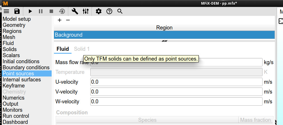

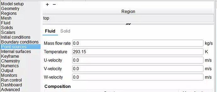

Can the point sources set the solid?As shown in the figure, solid cannot perform any operation.
If you hover with the mouse over a disabled MFiX control, you should get a popup message (“tooltip”) explaining why that control is disabled.
In this case, it is because only TFM solids can be defined as point sources.
(This is not stated clearly in the MFiX user’s manual - I’ll add it)
