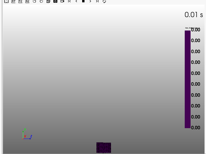

I try to use des_usr_var to output convection source in global energy source array.According to the description, Qcv is the heat transfer between the particle and the fluid, but the output value during my calculation is 0.I don’t know why,I use the dmp solver.

to your code shows that Qcv is in fact 0.
