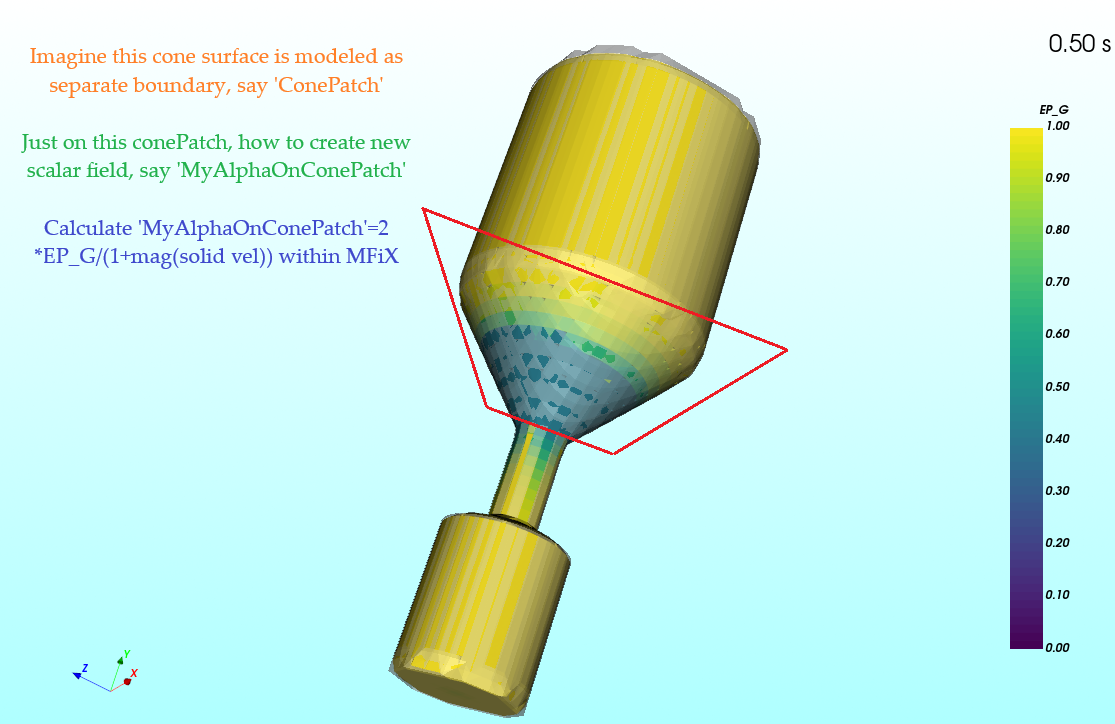

Hi @cgw, thank you for getting back to me. Please find below image showing my attempt on representative geometry.
+) As shown in image, can we define new scalar field ‘MyAlphaOnConePatch’ within MFiX-TFM and visualize it under VTK tab during transient and after run? ‘MyAlphaOnConePatch‘ is simple algebraic equation in ‘EP_G’, solid phase velocity on ‘ConePatch‘.
