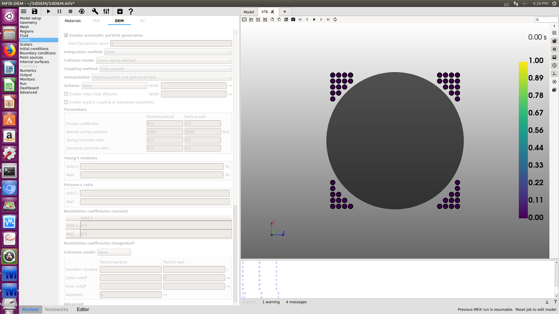

I’m running a cylinder case.
Screenshot%20from%202019-08-20%2016-25-51
1920×1080 221 KB
Choose Enable automatic particle generation to initialize particles inside the cylinder domain. But here is what I got. The particles are all outside the cylinder.
Screenshot%20from%202019-08-20%2016-26-05
1920×1080 259 KB
What’s wrong?
jmusser
August 21, 2019, 10:34am
2
Your cylinder is inside-out. You need to reverse the STL normals.
