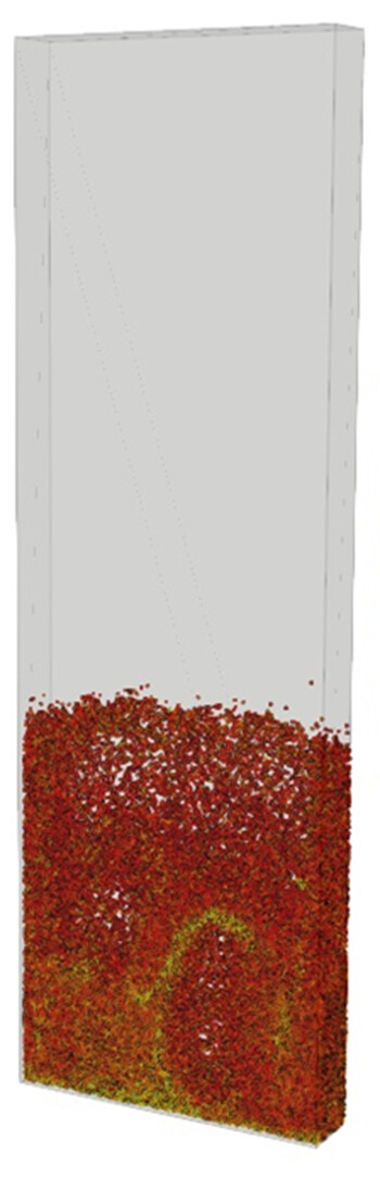

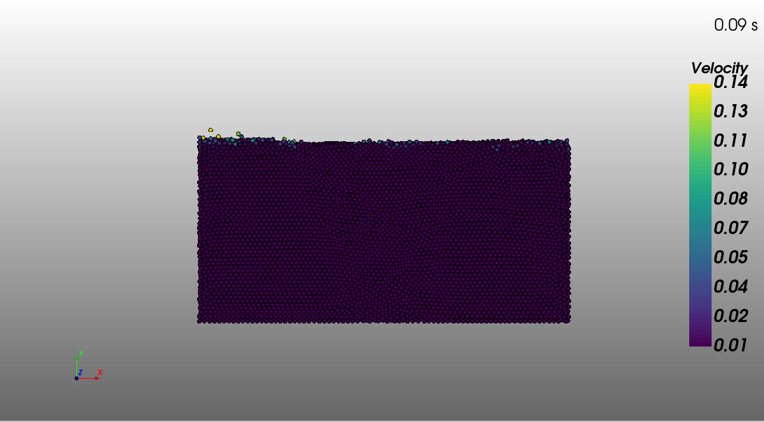

Please define your boundary walls and understand the geometry better to accurately model the fluidization behavior.
I have attached a few screenshots from my simulation case. Will be happy to help if you cannot figure it out.
