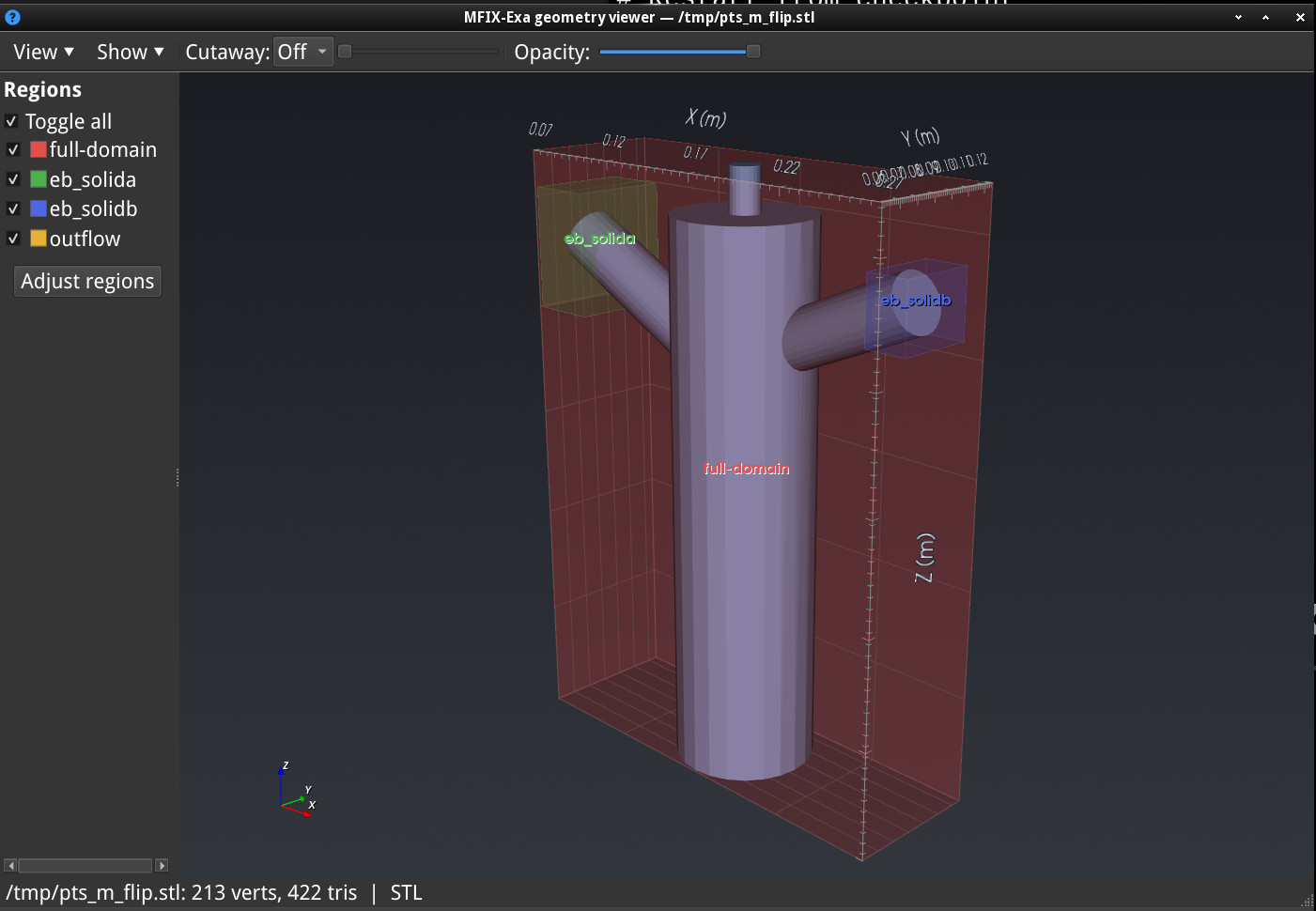

For what it’s worth here’s a preview of the geometry/regions:
There may be an issue with the definition of the outflow region (?)
It’s not shown in the preview, and the inputs file has:
regions.outflow.shape  = Box
regions.outflow.box.lo = 0.1545  0.0815  0.3020
regions.outflow.box.hi = 0.1815  0.1035  0.3020
Note that you have specified Box but the zmin and zmax coordinates are equal.
