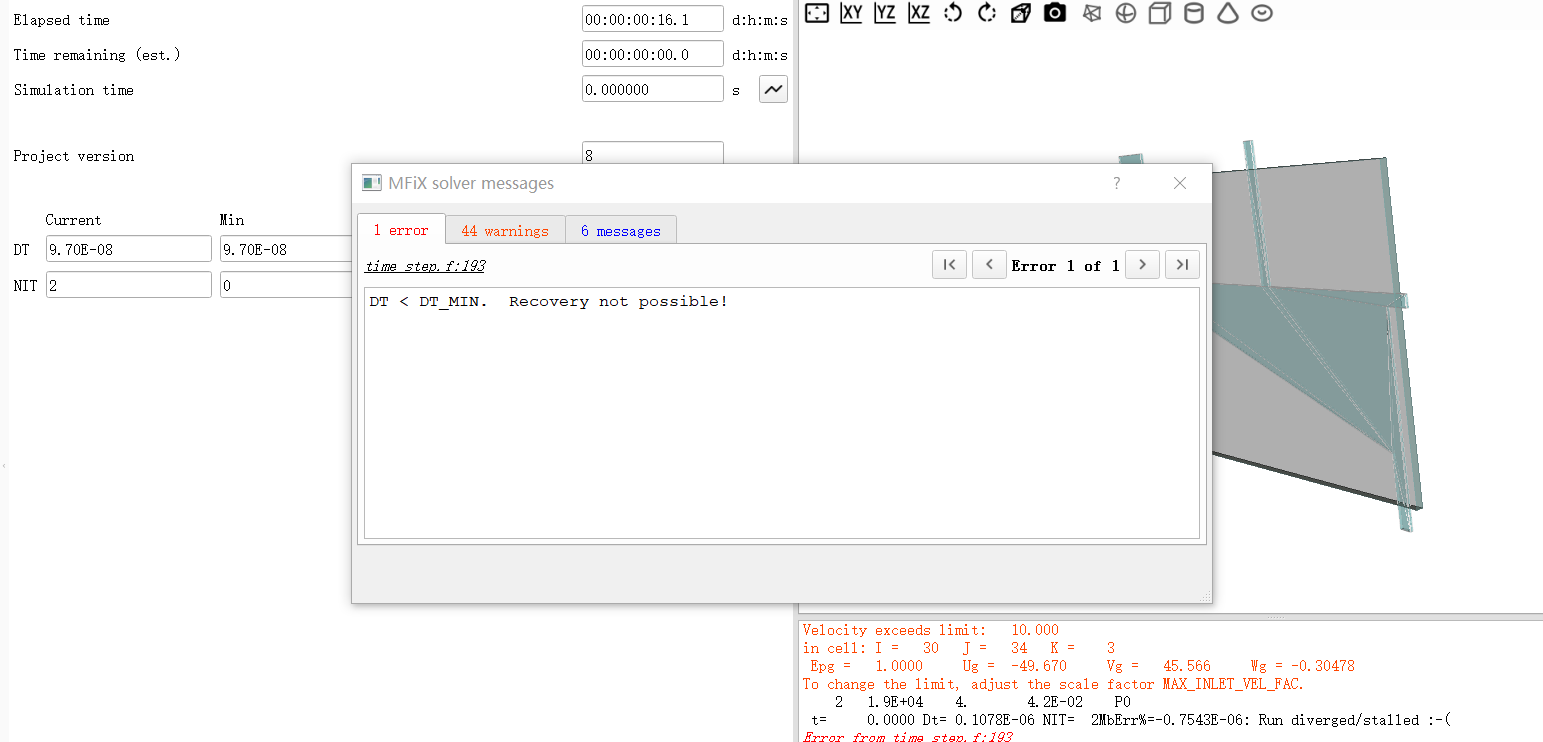

i was runing the 2d-mfix-dem,and the error message came out with dt<dtmin,and i checked all of the parameters i set up, and i don’t know why,please help.

Whenever you see DT < DT_MIN, it means that the model is not converging for some reason. If you look at the messages in the console, the solver indicates that a velocity inlet has exceed the MAX_INLET_VEL_FAC, which is 10 m/s.
So, I would check you BCs, make sure they are physical. Then, I would check the mesh to see if you have a small cell near one of the BCs that is causing the issue.
