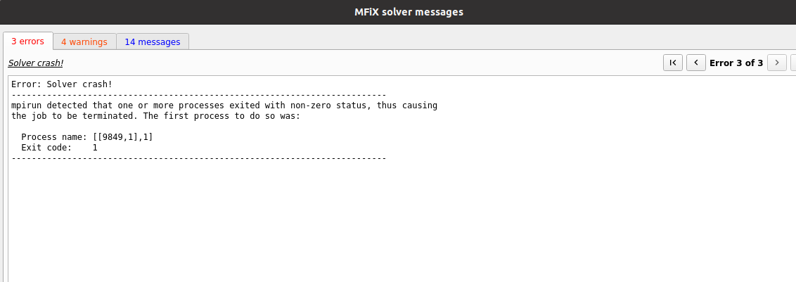

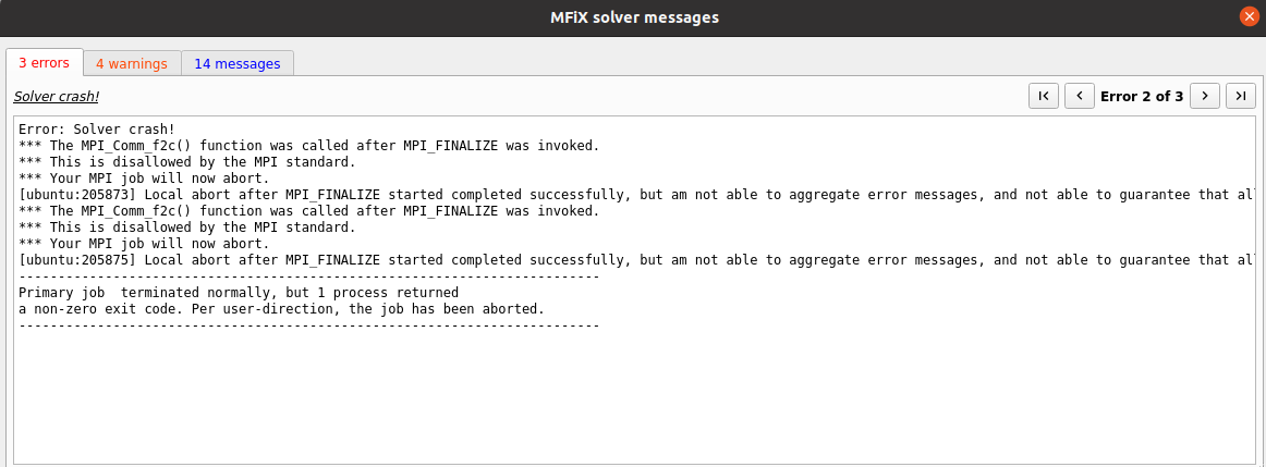

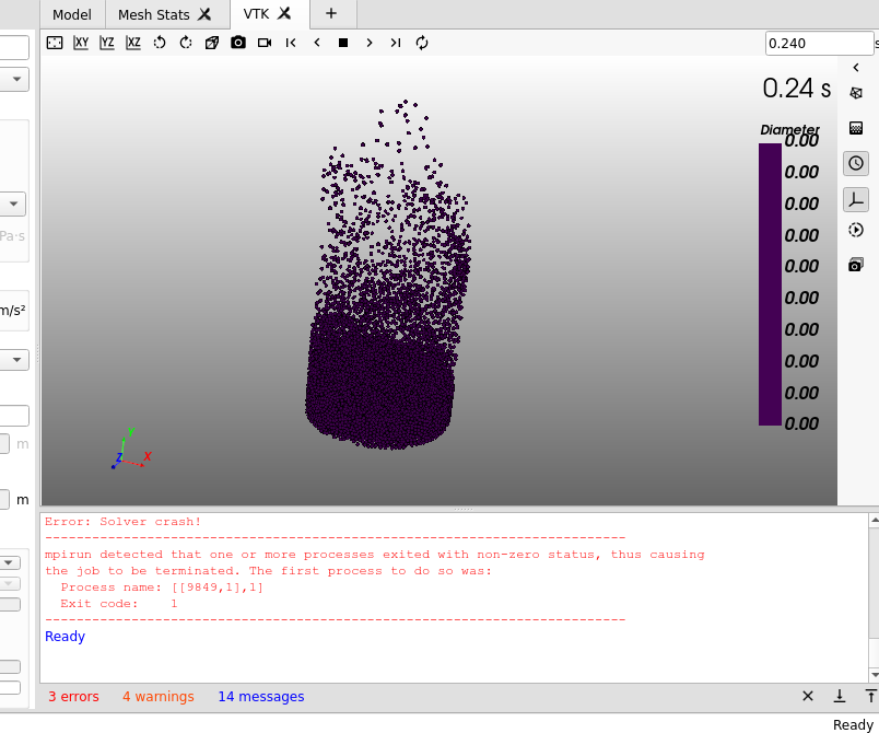

When I calculate a fluidized bed calculation case, errors will be reported whenever it reaches 0.24s. The error information is shown in figures. I don’t understand the specific reasons for reporting errors. I have tried many times and found that no error will be reported when the energy equation is not opened. Once the energy equation is opened, an error will be reported within 0.3 seconds. My example has been attached and I hope to receive an answer.

I uploaded the LOG file and zip file generated by submit the bug report. I found that the error in my calculation case is different from yours, only showing dt<dtmin. This probably means divergence, but I still don’t know where the settings caused the error. I would like to ask if you have any suggestions on where to improve this case so that it does not report errors.
