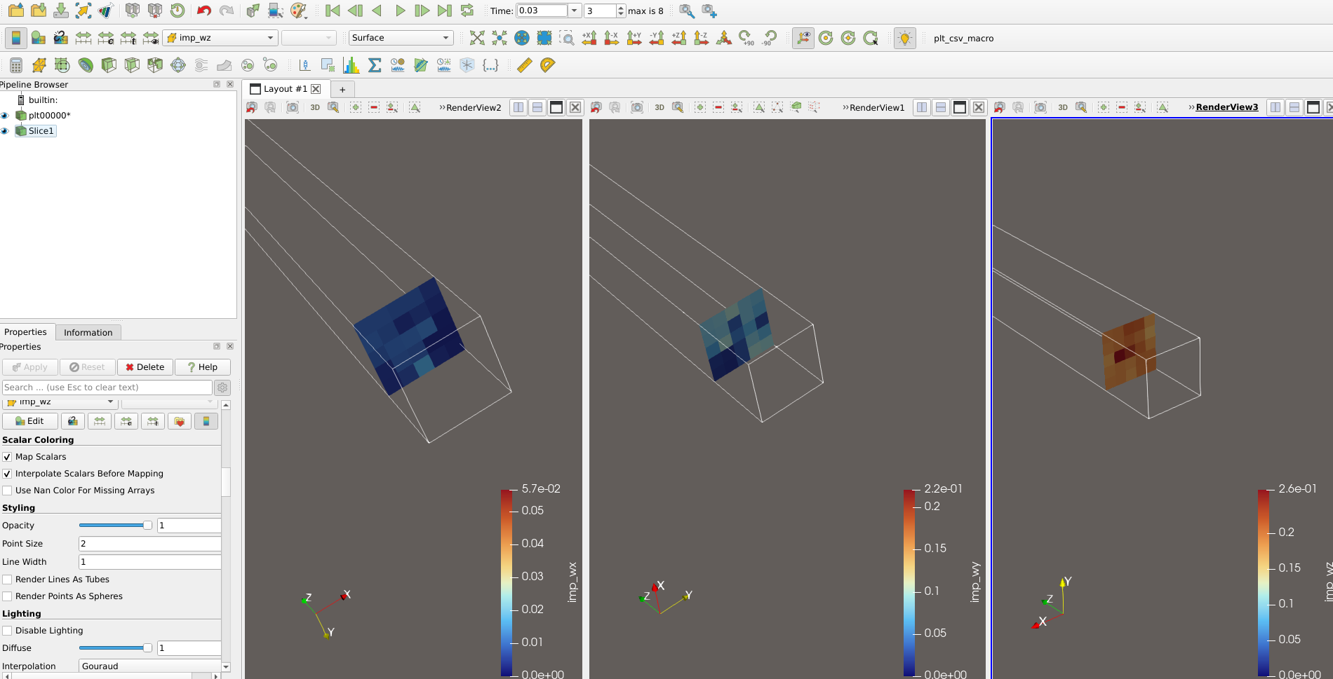

But this code gives me the results shown in the capture below.
I think the step 3. (indexing) logic is the problem, but I cannot find what is the problem.
Let me know where is wrong in my logic.

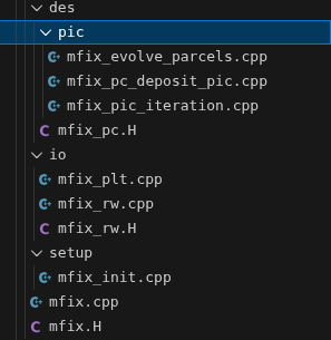

Modified file list:

What I focused in was data saving cell, which is outermost or no-slip wall boundary cell.
I needed to identify with which point the parcels collide. So I made an algorithm to accomplish this, see 24th slide. After finding “collision cell,” stack the impulsion vector in the identified cell.
Through this algorithm, the data should be stacked in only the outermost cells, but not in the inner cells. But the result told me “inner cells have data too.”
I couldn’t find the problem.. Please let me know how I can fix this.
