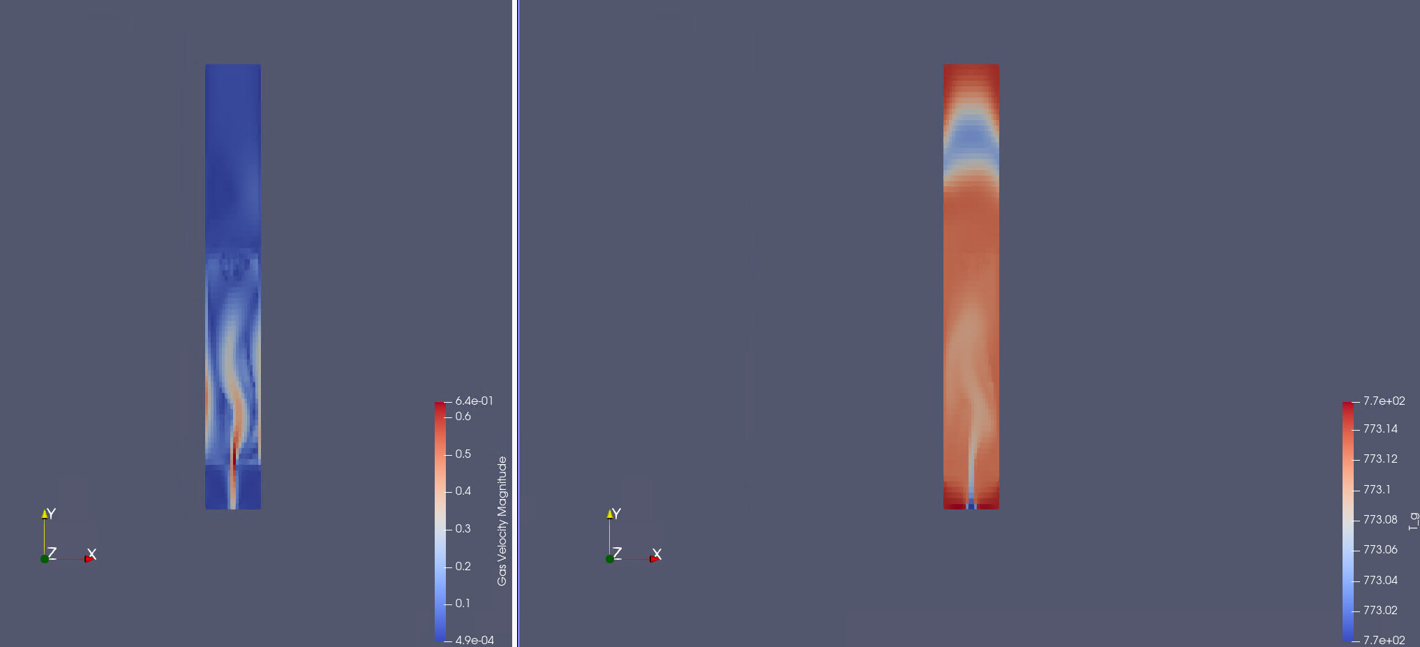

Hi all,
I am trying to set up a simple oxidation reaction using TFM, at first in 2D, where the reaction is one solid and two gases becoming two new gases. But I am still a bit puzzled that the reactions seem to happen - product gases appear, but there is no reduction in the reactant solid when looking at the inventory, and there is also no temperature change in the solid - there is expected to be about 150°K increase. And I have a sense that these two might be connected.
The project solver compiles just fine, and I have checked the possible kmol/mol mistakes in usr_rates.f. I have not set up heat of reaction, as I didn’t think this would be needed when only having one solid reactant.
What could be wrong here, or where to look?
