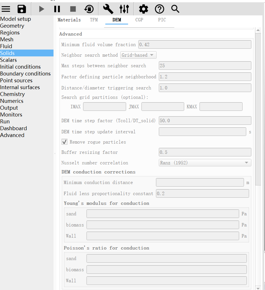

I am getting some errors when running this case but they don’t match the warnings in your posting (E_YOUNG_ACTUAL, V_POISSON_ACTUAL)
Maybe you attached the wrong case? Anyhow, here’s a breakdown of the 5 errors I get when I run the attached case:

Error 2:
Error from check_data/check_solids_common_discrete.f:601
Error 2200: The DES implementation of the stiff chemistry solver only supports explicit coupling (DES_EXPLICITLY_COUPLED).
So you need to also click on “Enable explicit coupling …”
Error 3:
Error from check_data/check_solids_dem.f:641
Required input not specified: DES_EN_INPUT(2)
Following the same procedure leads us here, where inputs are needed:
Errors 4 and 5 lead to the same place as error 3. (3 values needed, so 3 errors).
