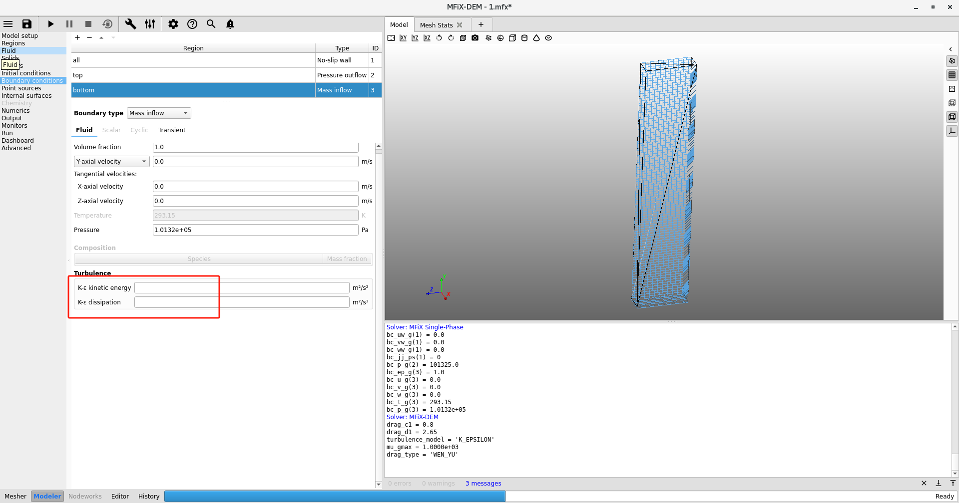

Hello, researcher! I encounter a problem in the value of k and epsilon in the k-epsilon model. I studied the relevant documents of the website, did not find the value of k, epsilon relevant content. How are these two values determined? Furthermore, what is the difference between the k and epsilon values of the (IC
) initial condition and the (BC) boundary condition? Is the value of the boundary condition the maximum? Looking forward to solving this problem! Thank you!
These are model parameters which it is up to you to specify. I suggest you look at some references for the K-epsilon model, starting here K-epsilon models -- CFD-Wiki, the free CFD reference
