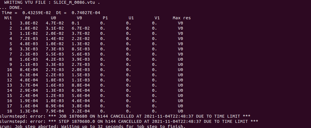

  3. I checked the two slurm .OUT files, I found out that they all began at t=0.0000s and stopped respectively at similar end times as follows. That means with the same core-hours, they accomplished similar workloads.
    PIC1: new start
    PIC1: continued one
    But at the same time the .vtu output files were generated consecutively in terms of sequence numbers as follows. (the new one begain around 16.00pm and the restart one began around 22.00pm)
I want to know whether it is normal that the simulation timestamp in the restart slurm .out file began at 0.0000s, which means that it represents relative progression only, and in reality it actually continued the last step of the previous “run”
