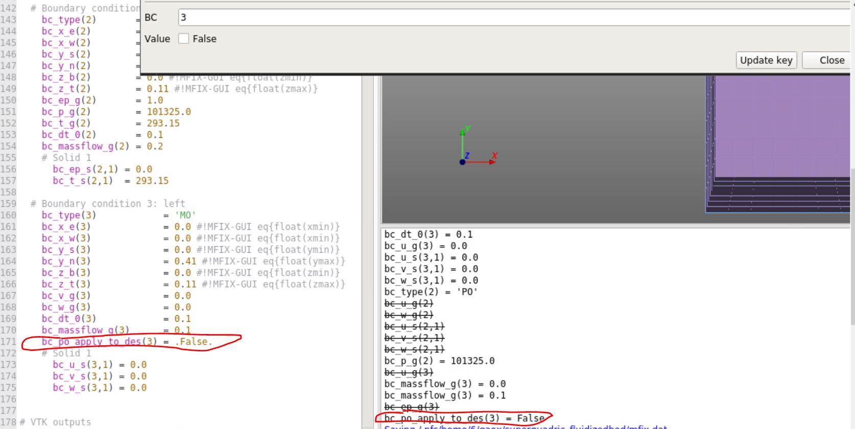

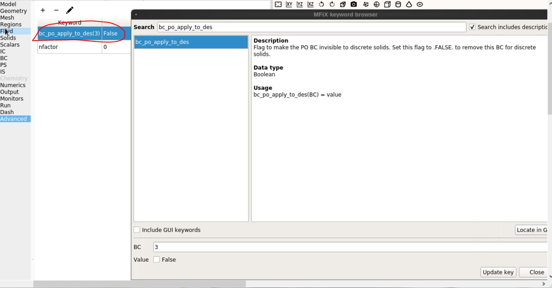

What is your outlet boundary condition? You can try bc_po_apply_to_des (bc) = .false.
Thank you for the quick reply. I found exactly what you have in the screenshot, but am not able to edit it - can you further advise?

Please clean the output files first in your project folder and then edit it (reset and start a new run).
You can also open the .mfix file and mannully add one line: bc_po_apply_to_des(3) = .False.
