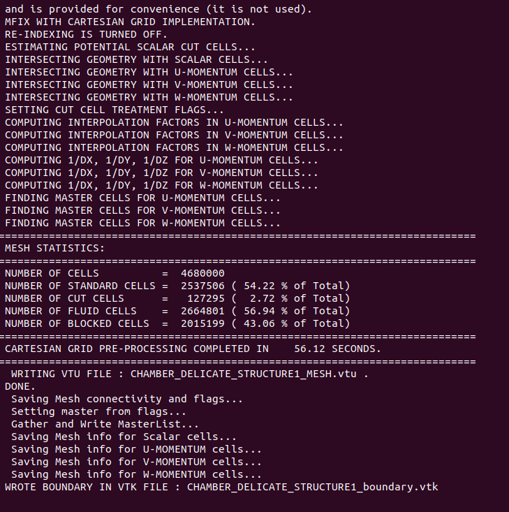

Thank you Charles. This time the task can be run in eith “srun” directly or SBATCH mode. It has run for 10 mins, but I can not still see the generated intermediate files like .msh, .vtk, etc. I wonder whether the job would not be killed(with running status) even it encountered some failure and stopped unexpectedly under the SLURM settings. Thank you in advance.
If in doubt, look at the log file (CHAMBER_DELICATE_STRUCTURE1.LOG)
Thank you Charles, the .LOG is as follows.
It seems that the mesh has been generated and saved, but I can not find it in the project directory with “ls -h”.
