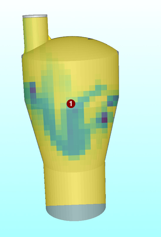

Hi everyone,
is there a way to create an inlet far inside a geometry/tank shown below in location 1), as point sources seems not to be available in PIC? Preferably it should also be very small compared to the cell size, at best 1-3 cells wide using the mesh below. I tried to cut out a volume inside the geometry, but the edges and cells became very messy. Should this work at all? Would the best option be to align a cut-out-box with the mesh cells, as to avoid cutting cells half way through - which possibly results in a mess, and perhaps just up to the cell extents or slightly past?
The image below is from a setup using a large IC of particles inside, but no real particle inlet.
