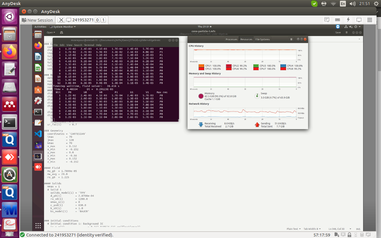

Anyone knows why my DMP simulation is interrupted as shown in the screenshot?
You could be out of memory.
May be… I have checked the memory usage during a simulation and I have found out that the memory usage increases over time. During the first times steps it was about 7 GB, 3 hrs later it was 15 GB and after 8 hrs it is now about 49 GB… WHY???
@mark.meredith @onlyjus As I have attached the screenshots, you can see that the memory usage was increased over time and the code now uses almost all the RAM!!!Stopping the simulation would rapidly drop the memory usage and running it again leads to a same situation. Our lab member believes that it is a memory leak, what do you think?Is it a code bug???

@onlyjus I address the issue. The problem is that using dmp on a single CPU with local cores apparently uses the number of cores that you need but it will lead to the memory leak, but using SMP does not leas to the memory leak. @mark.meredith may tell us more about this?
