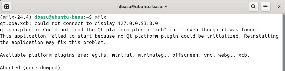

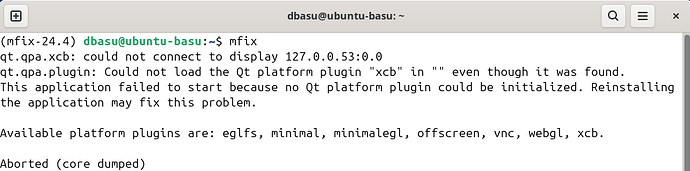

But whenever I am trying to execute the mfix command and start mfix I am getting this error message on qt
"qt.qpa.xcb: could not connect to display :1.0
qt.qpa.plugin: Could not load the Qt platform plugin “xcb” in “” even though it was found.
This application failed to start because no Qt platform plugin could be initialized. Reinstalling the application may fix this problem.
Available platform plugins are: eglfs, minimal, minimalegl, offscreen, vnc, webgl, xcb."
I have also attached a screenshot this message.
Kindly help me in resolving this issue. Any suggestion will be highly appreciated.

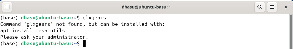

Does glxgears work for you on this machine? Can you run glxinfo and upload the output?

Seems like glxgears is not installed.
Kindly advice.
