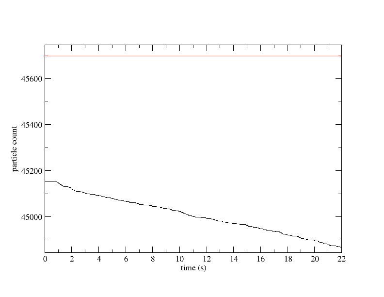

I was trying to figure out what was wrong with my Link case (I just figured it out, it has nothing to do with this…) and my first thought was that it looked like I lost a bunch of particles due to the initial transient so then the spout was just too strong. I do have bc.po_no_par_out = 1 set. I put a Lagrangian::GeneralProperty::Sum monitor on ones over the “full-domain” region to sum the particles, the result vs time is below. I’m losing some, but not in bunches like as if no_par_out wasn’t working correctly. Do you think my particles are just too soft and some are getting squished through the wall and deleted?

Back in the Link bed (case B1), I bumped the spring constant up from 43 kN/m to 170 kN/m (halved the collision duration). I expected to see it lose fewer particles, but it’s actually losing more particles (red line, still running). Curious.

This 2-D case (in red) does not lose particles. So they are slipping out through the corners. Still not sure why increasing the spring stiffness would increase the loss rate.
I’ve determined that particles are leaving through the pressure outflow and not the corners/edges of the domain. I’m guessing it’s a bit of a compound effect with one particle being thrown against the outflow by the jet, then another particle collides with it, pushing it outside the domain.
