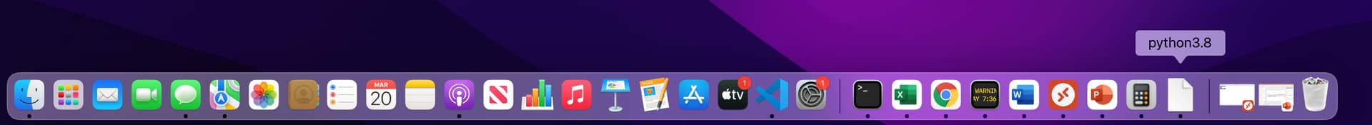

I installed mfix 21.4 on my Mac successfully. I followed all the steps. However, once I type “mfix” on the terminal and press “return” to run it, no window or anything appears (see the picture below). Could you please tell me what the problem is? Only a python 3.8 icon appears on the menu bar (see the picture below)
Thanks for the report. We’ve heard from a few other users that MFiX does not work on M1 Macs. We do not yet have a solution to this, sorry. Part of the issue is that we currently lack M1 hardware for testing. We are working on this, we’ll announce a solution when it becomes available. Thanks for your patience.

To all users having trouble with the Mac platform. I found this posting:
“Unfortunately, the current version of pyqt is also a huge burden for users running macOS 11, as Qt GUIs simply won’t open … unless users set the environment variable QT_MAC_WANTS_LAYER to "1".”
Can you try setting this environment variable and see if it helps?
