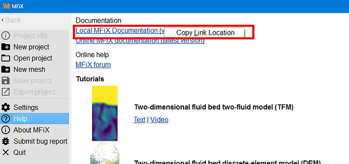

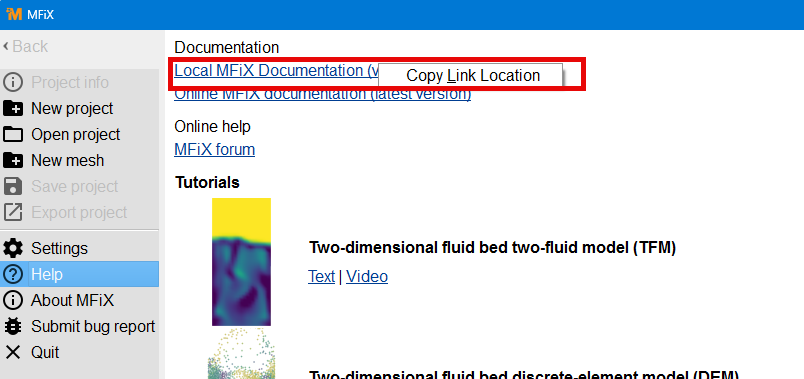

I’m using the latest 26.1 release but this minor issue is also applicable to other recent releases such as 25.X.
When attempting to access the local documentation on Windows 11, clicking the link in the GUI seems to be broken/not do anything?
If I copy the link address it has a mixture of \ and / in the path to the html file which I appreciate may be for cross platform support (\ for legacy windows) and (/ for unix or web) but is the slash inconsistency causing the problem or something else?
If I recall correctly this did work as expected in even older releases like 23/24.
Thanks
