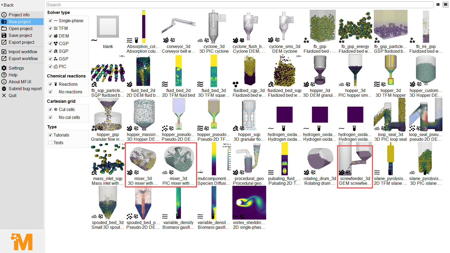

These cases may be helpful to you
Thanks for your reply. But in the cases you mentioned above, the fluid solver is disabled.
