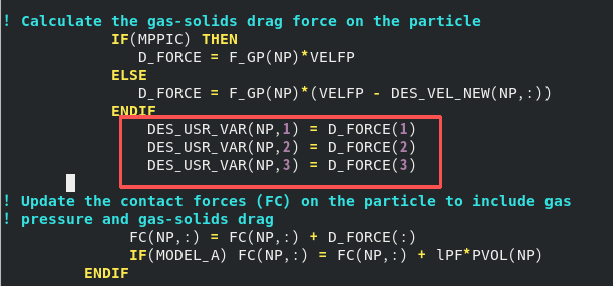

Based on some relevant posts on the forum, I added the following lines at the appropriate location in the `drag_gs_des1.f` file and rebuilt the solver:
DES_USR_VAR(NP,1) = D_FORCE(1)
DES_USR_VAR(NP,2) = D_FORCE(2)
DES_USR_VAR(NP,3) = D_FORCE(3)

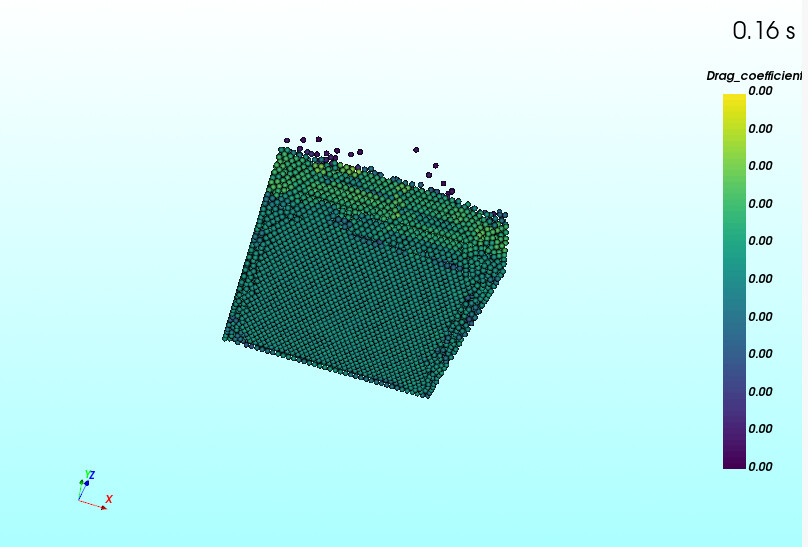

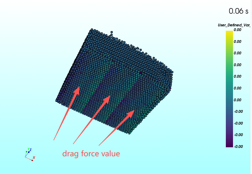

2. I noticed that the spatial distribution of the particle drag force exhibits an obvious regional or block-like pattern. It does not appear to be as smooth and continuous as the drag coefficient field. I am wondering whether this is caused by the numerical algorithm, the interpolation method, the mesh resolution, or the way the drag force is calculated and output in MFIX.
