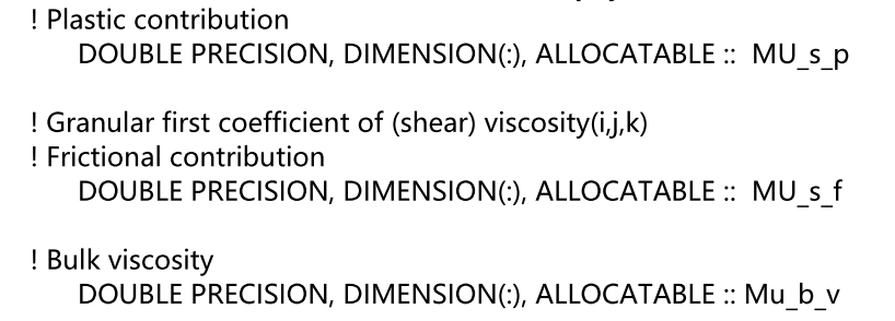

Recently, I noticed that source code of frictional contribution of solid viscosity in Schaeffer Model is not consistent with the equation written in Theoretical Review of the MFIX Fluid and Two-Fluid Models. The main difference is that the frictional contribution in the review is named plastic contribution in the source code. Relevant screenshots are posted below.
source code
equation

I notice that three contributions are clearly distinguished in cal_mu_s.f. But, in the theory reference Theoretical Review of the MFIX Fluid and Two-Fluid Models, plastic contribution is rarely mentioned. As posted above, the friction contribution in the reference is named plastic contribution in the source code. It seems strange.
