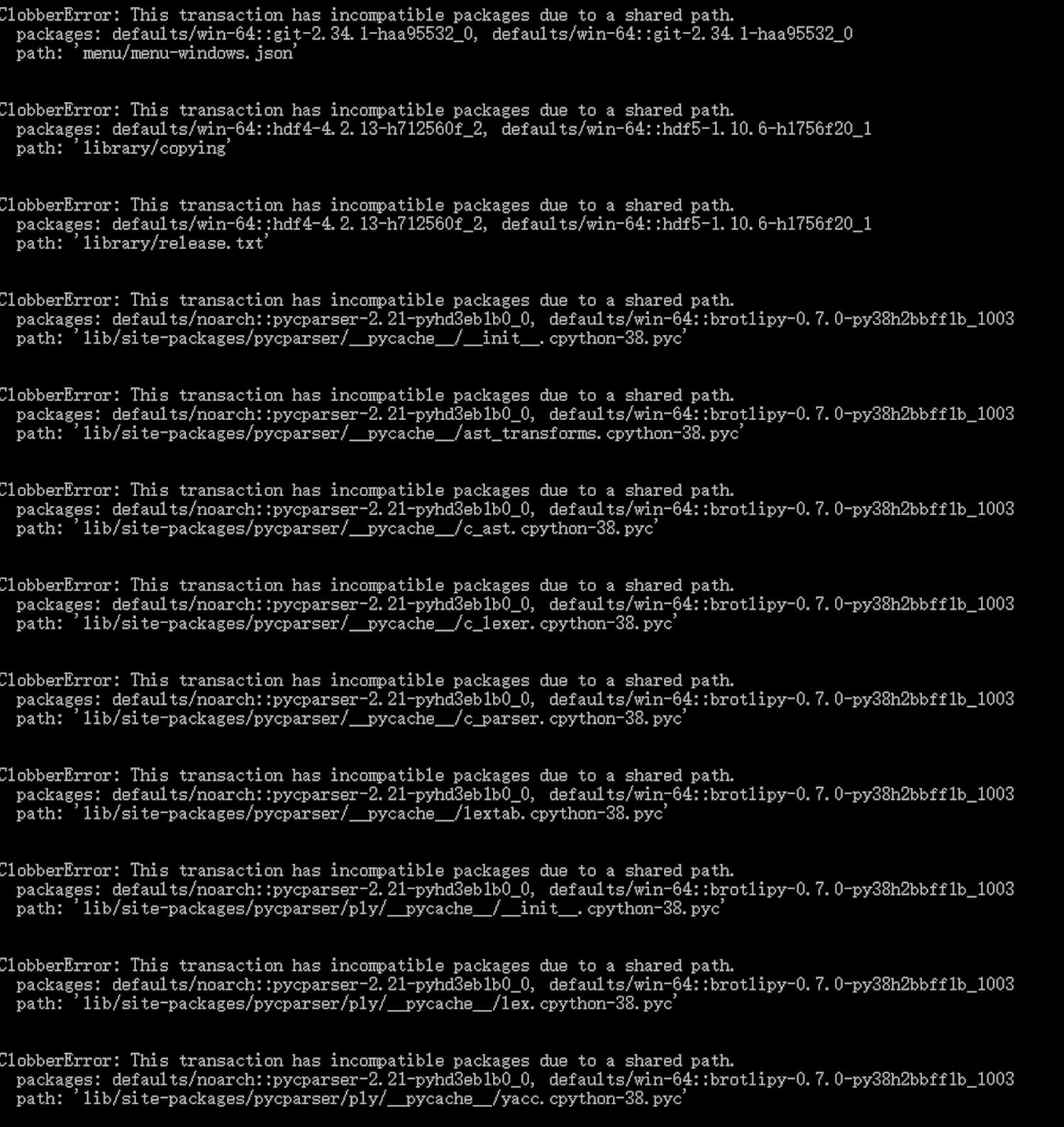

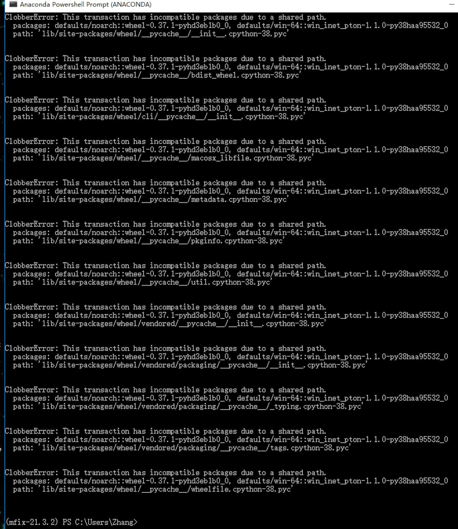

Excuse me, I have installed the MFiXs in my PC(Windows), of which 21.3.2 and 21.4 version both exist. Now I want to uninstall old versions and install the latest version, 22.3.
However, I found that I couldn’t uninstall the old version. When I try to uninstall both of them, my terminal window always says: “Verifying transaction: failed”, and other “CondaVertificationError” or “ClobberError”.
I have no ideas how to uninstall them. Could you please teach me the way to uninstall the old versions in my PC?
Here are pictures of my terminal window when I try to uninstall.
Hi @ZhuHe - I’m sorry you are having difficulties with Conda
I can see the errors in your screenshot but not the original command you typed.
