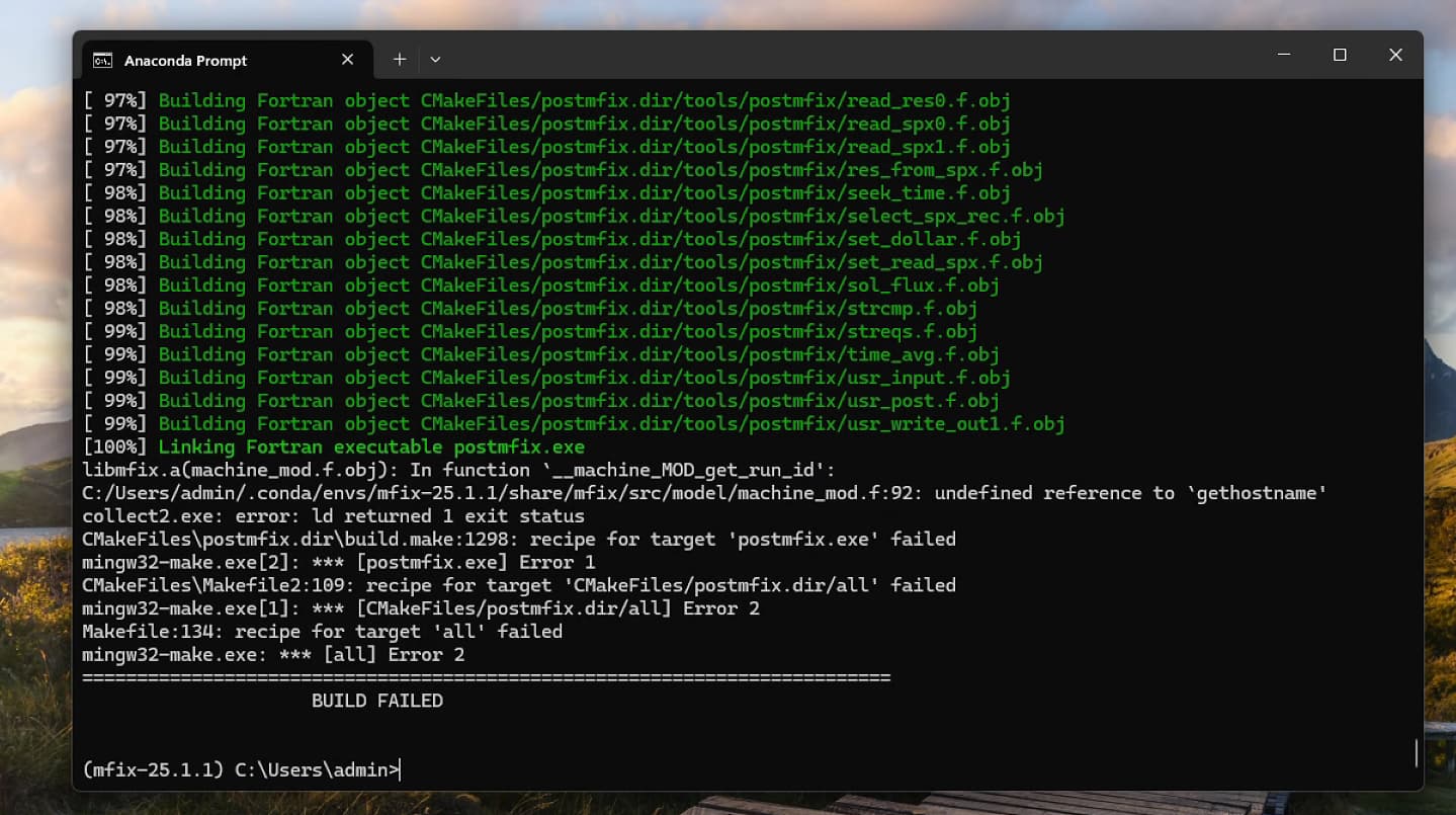

Hello,everyone. I encountered an error while building postmfix, as shown in the figure. Does anyone know what problem this is and how to solve it?
It looks like there’s a problem with building postmfix on Windows. We will fix this in the next release. In the meanwhile here’s a workaround:
build_mfixsolver --postmfix -DCMAKE_Fortran_FLAGS="-DMINGW=y"
Please let me know if this works for you.
Thank you, developer! Now built successfully.

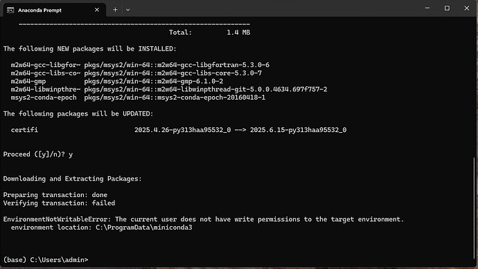

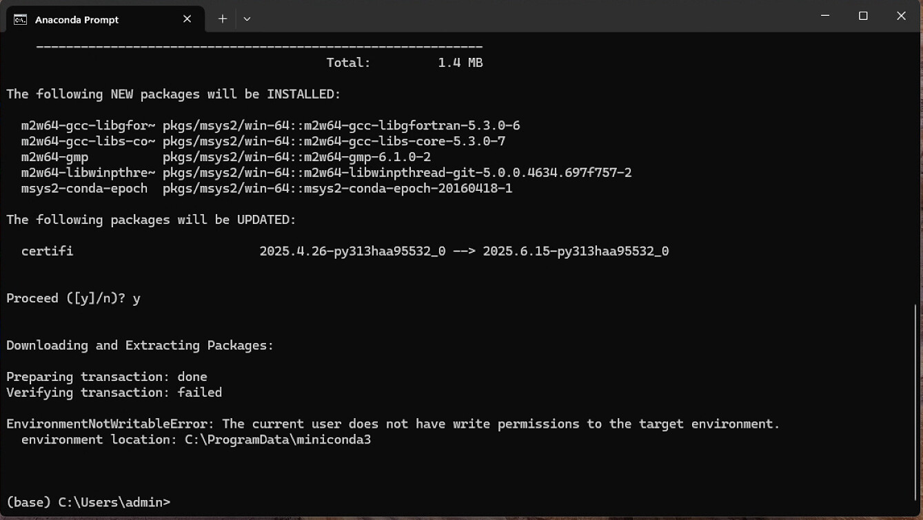

Hello, I am currently using MFIX 25.1.1. It is worth noting that I am also unable to use Paraview on this computer. I guess it’s a problem with the system environment, but I don’t know how to solve it either. I tried reinstalling the Fortran section according to your method, but encountered an error as shown in the picture. Also, may I ask how I can help you reproduce this question?
How did you install Miniforge in the first place? We suggest doing the “per-user” installation instead of the “system”.
