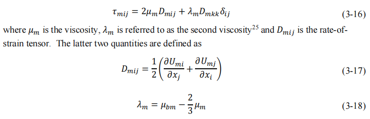

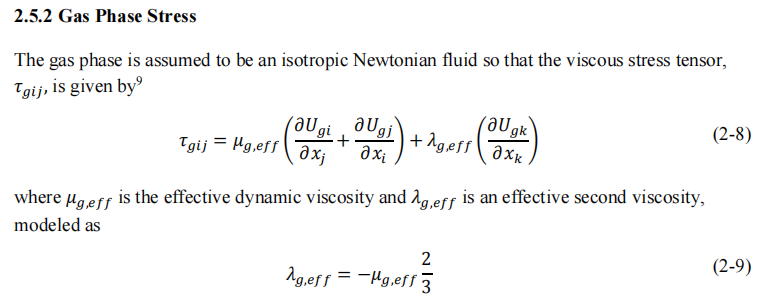

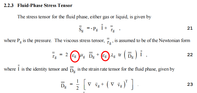

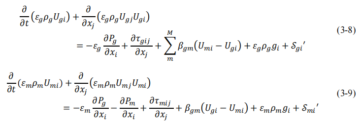

Q1: Are the conservations of momentum for gas and solid phases in the Theory Guide (1993) expressed in the Ishii formulation? Volume fraction is involved in the expression of stress tensor there while it is not included in the default formulation for Model A in MFIX.
① In the Theory Guide (1993)

② In the Theoretical Review of the MFIX Fluid and Two-Fluid Models (2020)

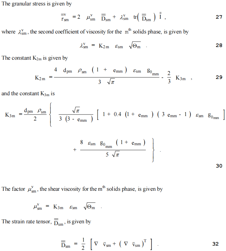

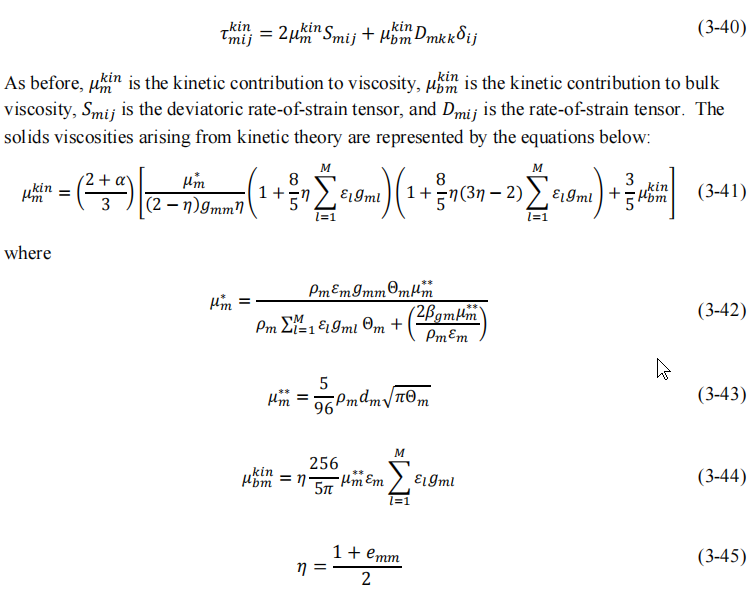

Q2: The kinetic model for solid stress in the Theory Guide (1993) is different from the one in the Theoretical Review of the MFIX Fluid and Two-Fluid Models (2020). Which one is right?
