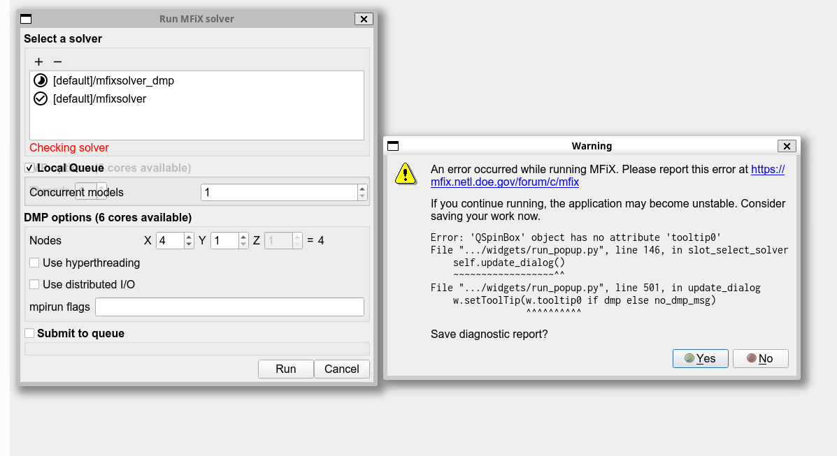

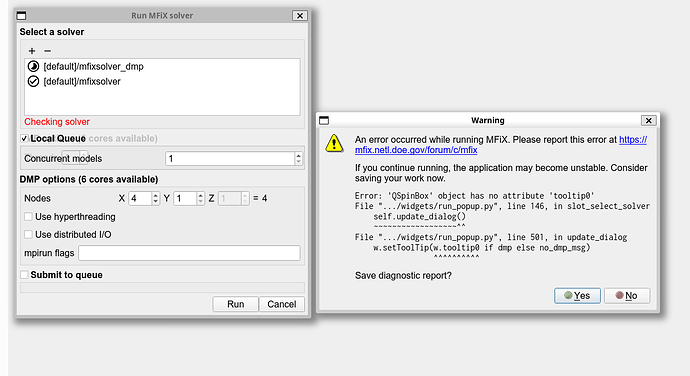

Run dialog errors/warning
Versions:
  • Mfix: 25.2.1
  • Nodeworks: 23.1.0
  • OS: Fedora 42 guest VM inside Windows 11 WSL.
Three errors/warnings in a row are issued upon clicking the Run button in DoE. After selecting not to save a diagnostic report for each of them, the runs do start as expected, even if there seems to be some issues with the GUI and choice of local queue. So not a fatal bug, only scary.
It seems the error happens when points are excluded after the import, meaning inside the plot or design table.
